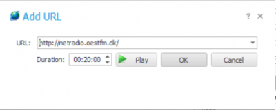

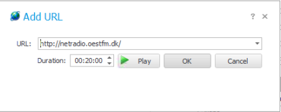

In a script we use "Loadtrack" press CTRL and click on "..."
then you can select a URL-stream. Set the time for play.
and do the rest of the script.

This is ONE option - and make sure to set the options SuppressHistoryCheck, SuppressAddHistory, KeepStreamLoading and KeepStremAliveOrSuppressRestrictions for script-line 2 (the LoadTrack URL one).
When you specify a Duration for the stream (in the above example 20min.), but you want to end it earlier you can simply press 'Play Next' to do so manually.

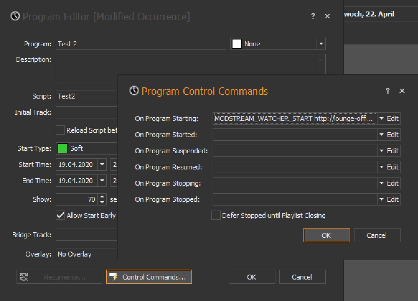

On way here is to create a program which e.g. runs for the given full hour. Let it start Soft and specify for its Control-Commands the following for the On Program Starting event:
MODSTREAM_WATCHER_START http://lounge-office.rautemusik.fm|1800|true|true|MySongTitle|false|C:\Temp\test.mp3
In the On Program Stopping/Stopped event you might also stop the mod stream.
Notes:
The test.mp3 denotes your Intro file.
The duration denotes your maximum duration in this case 30 min.

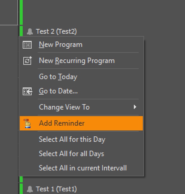

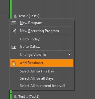

Another option is to use a reminder, which might also work to trigger the above control-command.
