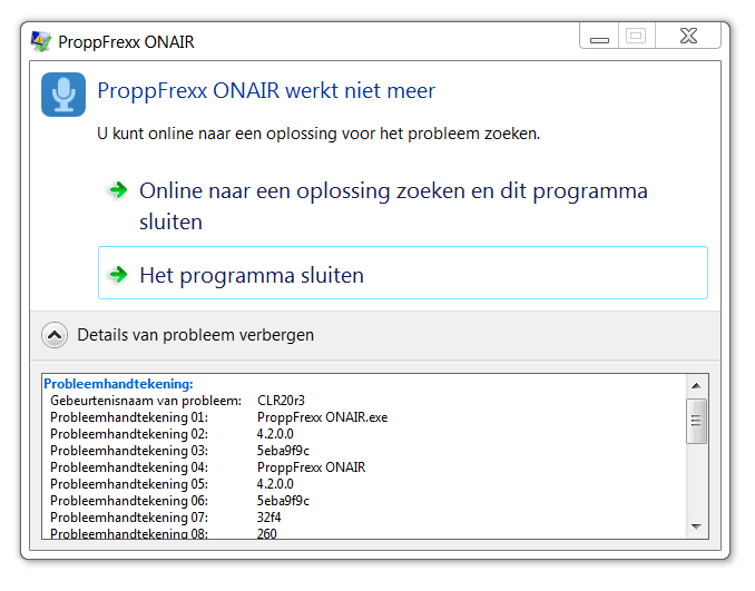

Thank you very much! Unfortunately PFOA won't start after updating.
Are there specific system requirements for this build? The installation finishes succesfully but PFOA cannot start after the update.
I'm still on Windows 7 since my old Mac with Bootcamp unfortunately isn't compatible with Windows 10...
I've reverted to the previous version for now.
Cheers,
Frank
Re: Moving a track insert sometimes results in duplicate insert
On some system a new dll was needed, which was missing.
A new v4.2.0.1 is now available!
