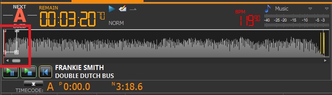

And another annouing something that i would like to solve.
Of course, right mouse and delete but it shows evevytime again. Several files do have this ( i guess it was saved when i used that song in a voicetrack session). I've saved, deleted de .pmfp etc but nothing helpes.
Is there a way to delete this? Quet irritating during a nonstop session.

b) Meta Data like volume points might be stored to the following locations:
1. Audio Files TAG data
2. The extra meta data file .pfmd
3. the playlist file
To remove 1. or 2. you can for example go to the TAG Editor dialog (Alt+3) on the media entry or use the TAG editor icon the the player (in your above image it is the small middle top icon next to the time display).
In the TAG editor dialog make a right-click on 'Save Meta Data TAG' resp.'Save Meta Data File (.pfmd)' button to remove all meta data from the TAG resp. .pfmd file.

HI Bernd, this is what concerns me.
radio42 wrote: 05 May 2020 21:47 In the TAG editor dialog make a right-click on 'Save Meta Data TAG' resp.'Save Meta Data File (.pfmd)' button to remove all meta data from the TAG resp. .pfmd file.
I already deleted all .pfmd files in the folders, but somehow it reveals again after deleting.
Thats why i'm asking.

Posts: 9160
Re: Start Cartwall
Please read my post above again.
I assume, that you saved the meta data (volume-points in your case) to the TAG data of the audio file!
As such, it won't help, if you remove the .pfmd files (which is simply another, alternative way to save meta mata).
Thus: open the file in the TAG Editor and make a right-click on 'Save Meta Data TAG'

radio42 wrote: 06 May 2020 12:37 Please read my post above again.
Thxs, this problem has been solved. On the other hand, i don't get it concerning the airlite.
