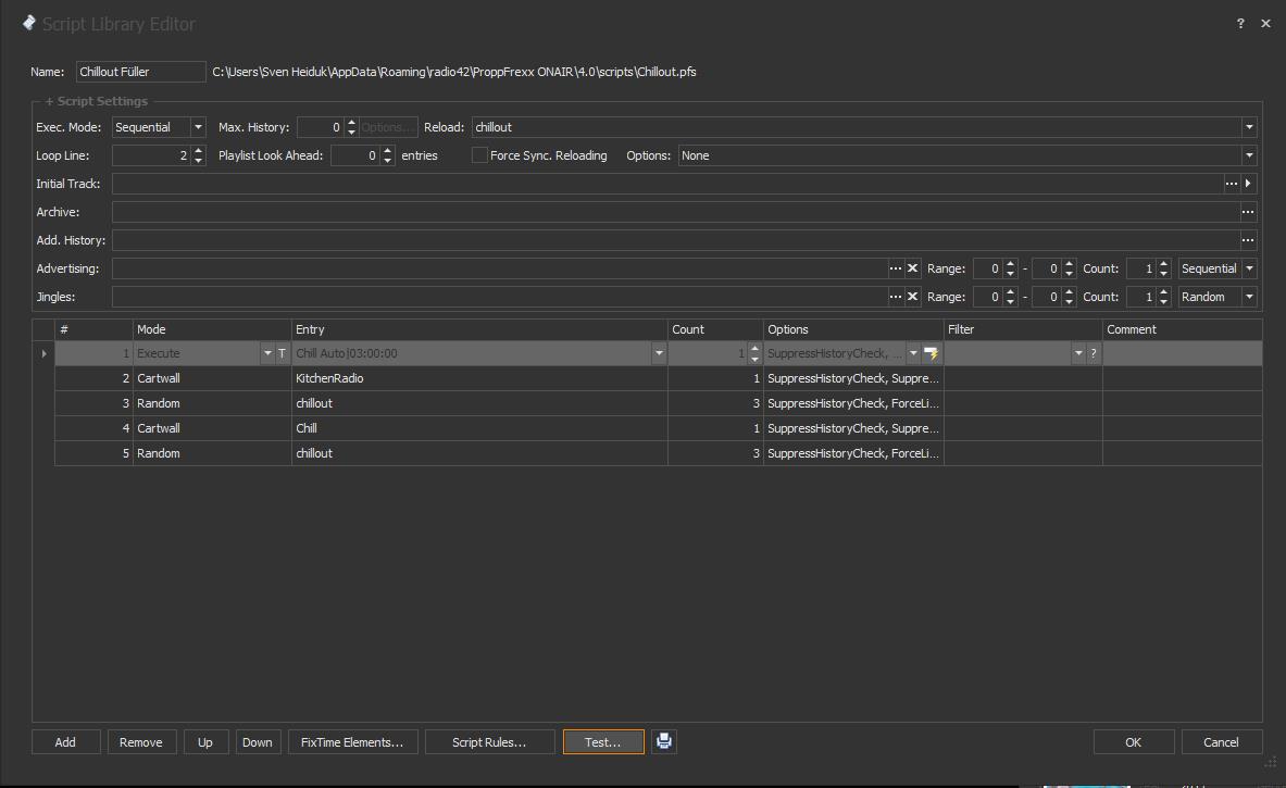

I tried the Script Library function to prevent repeating the title. However, when I reload the script, I'm not sure that it won't start over. and it don't work.

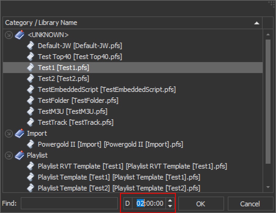

To also overcome this you create another script (which you then effectively use in your program) - let's call the initial Script 'Test1' and the new one Test2 (and specify LoopLine=2).
In this 2nd script you now define 2 script-lines:
1. Execute, Test1 (see picture below and specify 02:00:00)
2. Random, OtherLib
The Test1 script is like previously:
1. Sequential, YourLib
This 2nd script now does the following:
It executes the Test1 script so that up to 2 hours of tracks are picked from YourLib.
After that it loops the 2. script line to pick tracks randomly from another lib.
This ensures, that the over-scheduled tracks are only picked from the other lib.

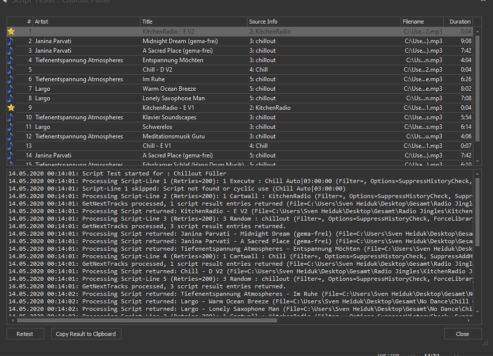

Well, if you look to the Test output. You already see, that the 1st script-line could not find the referenced script. Or that you used a cyclic reference!

Its look like it is running THX
