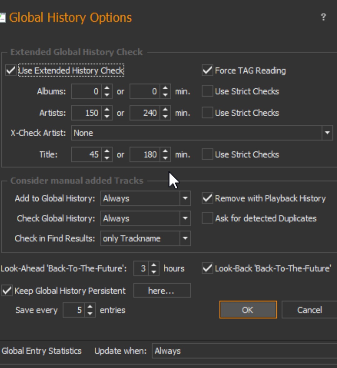

Both 'Back to the Future' options are on. See below. What are the hours for and how many hours should I set it if we have 8 hours rvt a day? 8 hours?

That depends on far back/infront you like to look.
E.g. 3 hours means it would look 3 hours back resp. infront.
If it then finds an already pre-created playlist (i.e. a script with a LoadPlaylist as the 1st script-line), it would read in such playlist and load these tracks as additional history entries.
These additional history entries are then check with the current RVT/playlist creation for that RVT session.
