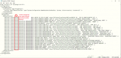

Trying to transfer all files to another computer and having problems.
1. Successfully transferred the master folder (includes all media libraries) from machine 1 to machine 2
2. Successfully transferred the appdata folder (includes all files) from machine 1 to machine 2

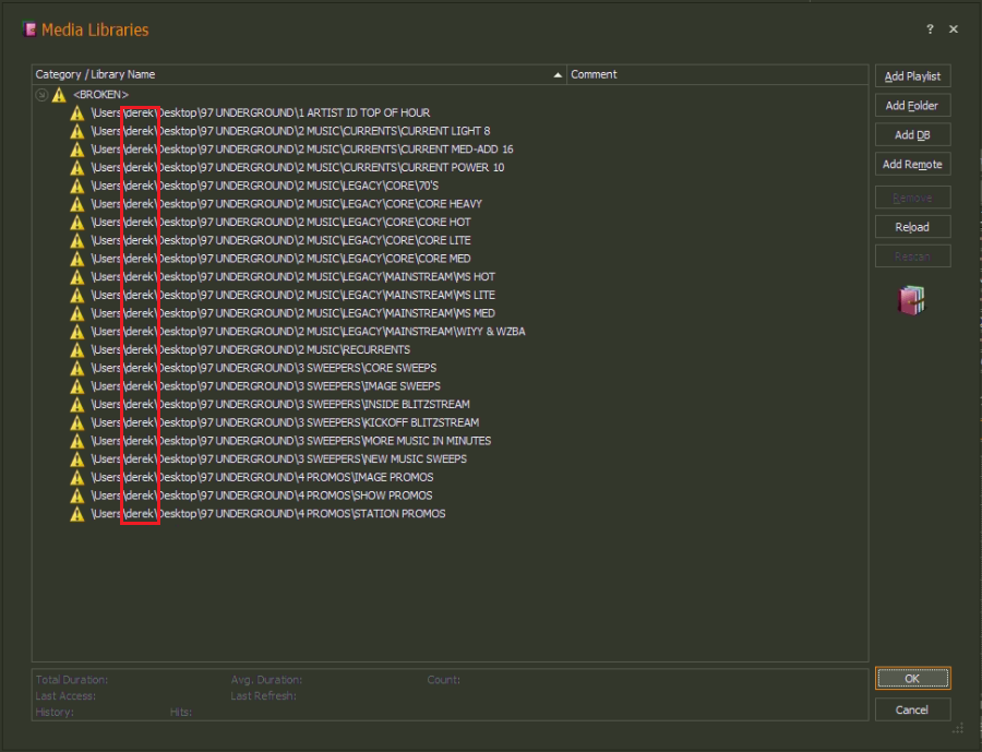

3. Open ProppFrexx on machine 2 and go to media libraries. All links are broken (see below)

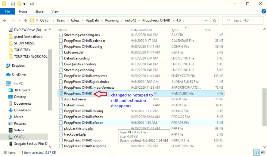

4. Went to appdata folder and accessed file (ProppFrexx ONAIR.scriptlibs) and corrected the user (replaced \derek\ with \tom\ in the path. (see below but changes not reflected in this screengrab)
5. Noticed when i saved the file, the extension is missing from file title.
6. I manually added the .scriptlibs to the title. OPen up ProppFrexx, go to media libraries and the errors are gone but no libraries appear.
Please help us properly transfer files from machine 1 to machine 2, what files need to be edited to fix broken links. Also, is it a problem that the file is now associated with notepad? Can't seem to get it back to "Pick An App" mode.

Manually rebuilding the libraries is exactly what I am trying to avoid! Yes, there is one difference in the file path as indicated in the second pic above. Why can't \derek\ be replaced with \tom\ in the "ProppFrexx ONAIR.scriptlibs" file? Isn't this telling ProppFrexx where to look for the libraries?
Path in Machine 1
C:\Users\derek\Desktop\97 UNDERGROUND\1 ARTIST ID TOP OF HOUR" value="0||False|True|False|28|True|ARTIST ID - TOP OF HOUR||6|ARTIST ID" />
Path in Machine 2 (confirmed by viewing properties in the 97 Underground folder on the desktop)
C:\Users\tom\Desktop\97 UNDERGROUND\1 ARTIST ID TOP OF HOUR" value="0||False|True|False|28|True|ARTIST ID - TOP OF HOUR||6|ARTIST ID" />
Recreating the libraries is the ONLY way?
Re: Transfering Libraries & appdata files to another computer
No you can of course also edit the .scriptlibs manually. Should work.
With Media Libs this might be a bit more tricky, in case also playlist based media libs (.pfp files) might be effected. Playlist files store relative path positions to the audio files....

I did edit the .scriptlibs manually before contacting you. It resolved the broken errors but did not show ANY libraries. Is there another file I need to edit?

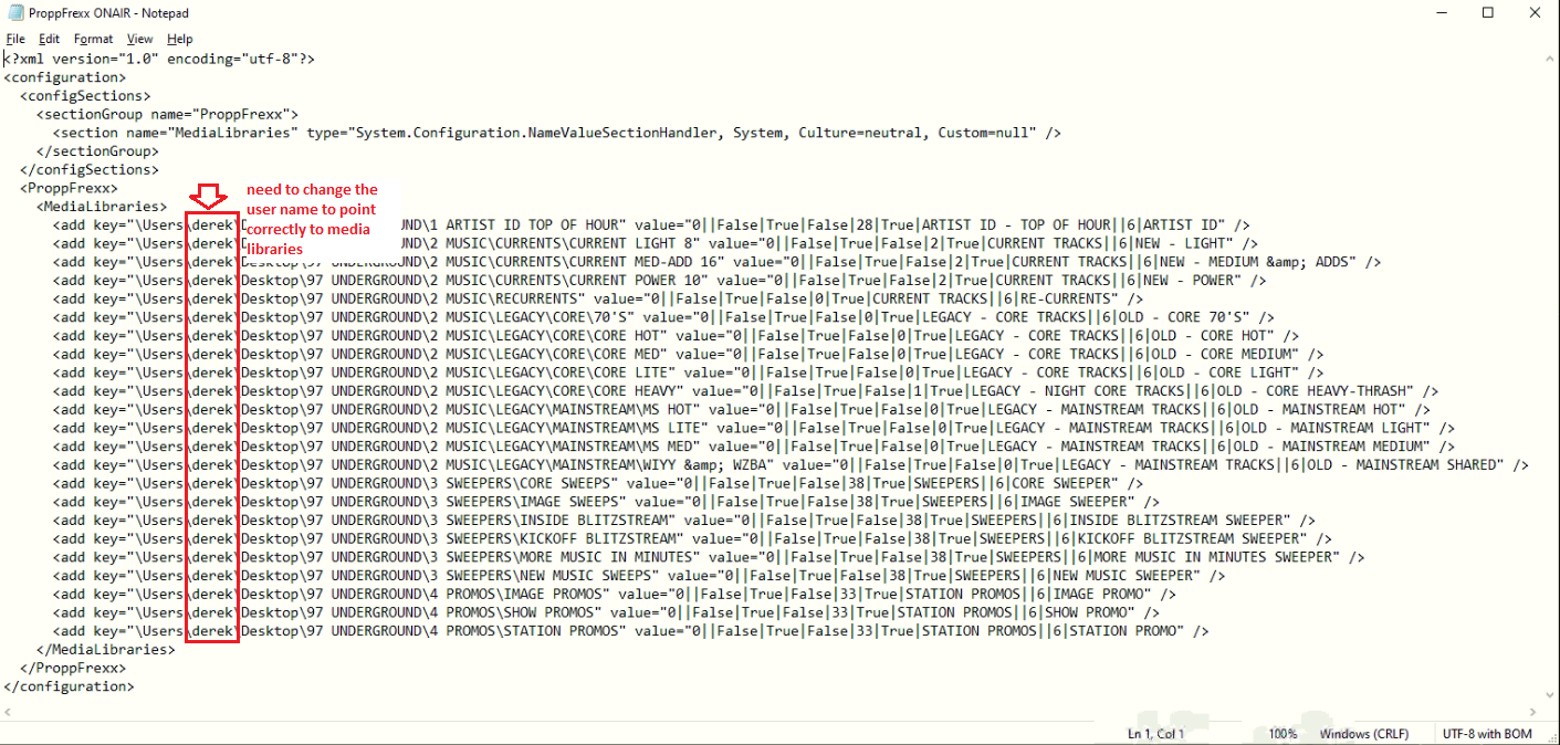

Then you made some mistakes maybe?! I don’t know and I guess it is hard to say. You also mentioned you saved them incorrectly without the extension.
I am also not sure what you mean my „ did not show ANY libraries „. A script only contains script-lines, which might reference media libraries.
In your first screenshot you have shown those broken media libs. But you never wrote that you also fixed those!! As written in my post above: you also need to modify and adjust the .medialibs file! Not only the .scriptlibs file!
D3R3K
Posts: 51
Joined: 18 Aug 2020 00:29
Post by D3R3K »
No i didn't save them incorrectly. the files that needed editing had no associations with them. When i doubleclicked the file to open, was asked to pick a program to open the file. I chose notepad, it opened, i edited the path correctly then saved it. THEN...noticed that the extension was not in the title. SO...i then edited the title and added the extension to the title. After doing this, i went to media libraries and ALL of the broken links were gone. So now the window is empty (no broken links, no media libraries, a blank window ready to manually add the libraries again which is what i was trying to avoid.

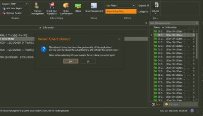

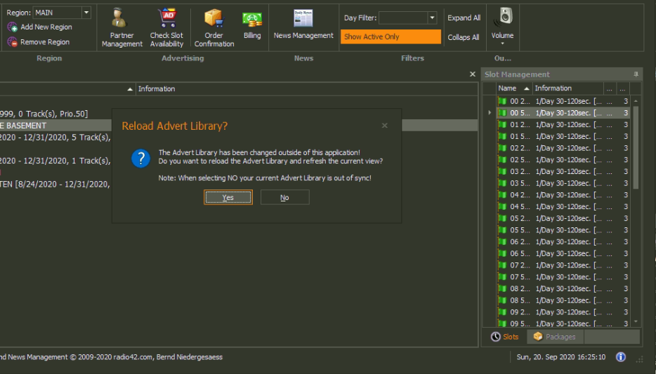

Also having the following problem on machine 2 with adverts & slots:
it is telling me to sync the library...

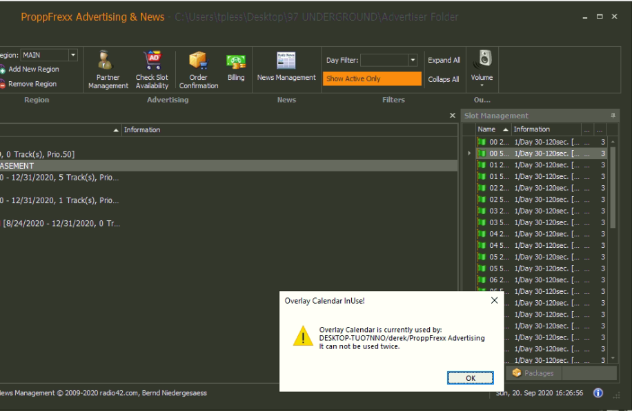

i select "yes" and get the following message...
I appreciate the help that you have offered but at an extremely frustrated state again. I have been at this for 6 weeks and was hoping we would be moving forward with purchasing & licensing but all I can ever report back to my client is "more issues to work out"! I am confident that your software is a great solution to our needs but the forum method to get help is not working for me. I have watched EVERY video several times and only been able to make small progress.
Regarding the screenshot issues - which also seems to have been created due to the copy action:
Please close the Advert Management.
Now go to ProppFrexx ONAIR and go to the Scheduler ribbon tab and open the Overlay Scheduler, BUT hold down the CTRL+ALT key together when clicking on the Open Overlay Scheduler button!
This will force a release of any existing lock (which should prevent two users accessing the scheduler in parallel and overwriting each other).
Now you should be able to to open the Advert Management again without issues.
