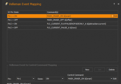

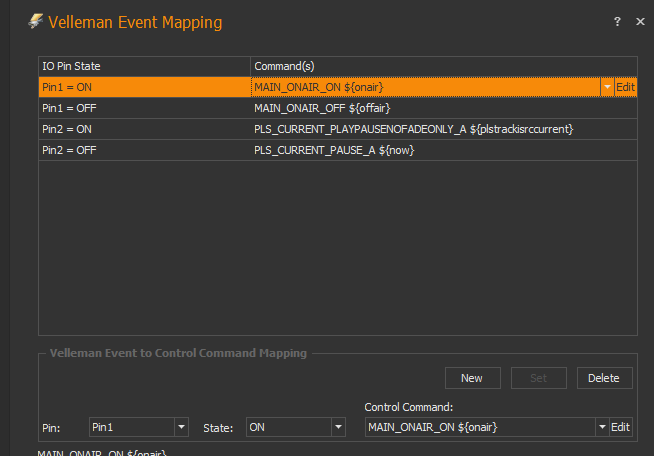

this is what I got so far, you were right, in playlist settings none of autoload or offload were selected.
I changed this. And now at the end of track it moves on to the next for playerA, but when fader is off, the player goes into pause. That is not what I had in mind. it would be great it moves to EOF.
