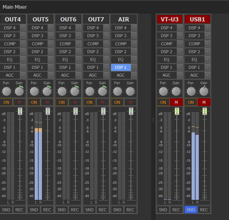

I would like to add another mixer channel to my existing setup to output to my headphone jack on the PC (I know, not ideal, but it's just a home hobby studio). The idea is that I would add a VST processor (Stereo Tool) to this channel so I can listen to the 'on air sound'.
I've succesfully created the channel and it does output sound (for instance when I route my standby players to it). However, I cannot seem to copy my main program signal to this new output channel.
I have a 'main' input channel that receives my mixer output over USB. I've opened the settings for this input channel and set 'output to' to my new headphones output channel. However, no sound is sent to this the headphone channel. I've also used 'SND' below the input channel to try and copy the signal. Unfortunately, also no sound.
Both channels are using WASAPI. Any idea what could be wrong?
Cheers,
Frank
Cheers,
Frank

Small update: the problem doesn't seem to be the new channel, but I can't sent audio from an input channel to an output channel (even though I can select the channel).
So when I copy other output channels to the new output channel it works. When I copy the input channel (or another input channel) to another output channel, it also doesn't work.

Re: Problem creating mixer output setting
Oh, but there screenshot shows that it is muted!
See the ‚M‘ button above the fader, which is dark red!
Click on it to unmute.
Wow, I feel really stupid...
It works now... I was under the impression it wasn't muted, since the meters showed volume and I did receive audio input...
