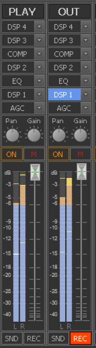

I have installed VST 64bit version of stereo tool on mixer channel OUT.
How to record this channel to the file (wav, mp3... whatever) after DSP?
Is it correct what I did? (on attached picture).

Yes looks correct!
And here it is recording the audio signal AFTER the DSP (make a right-click on the SND button and it should also show Signal:Post Fading, which is also the default).

Yes, affirmative. SND right click and I can see "post fading".
