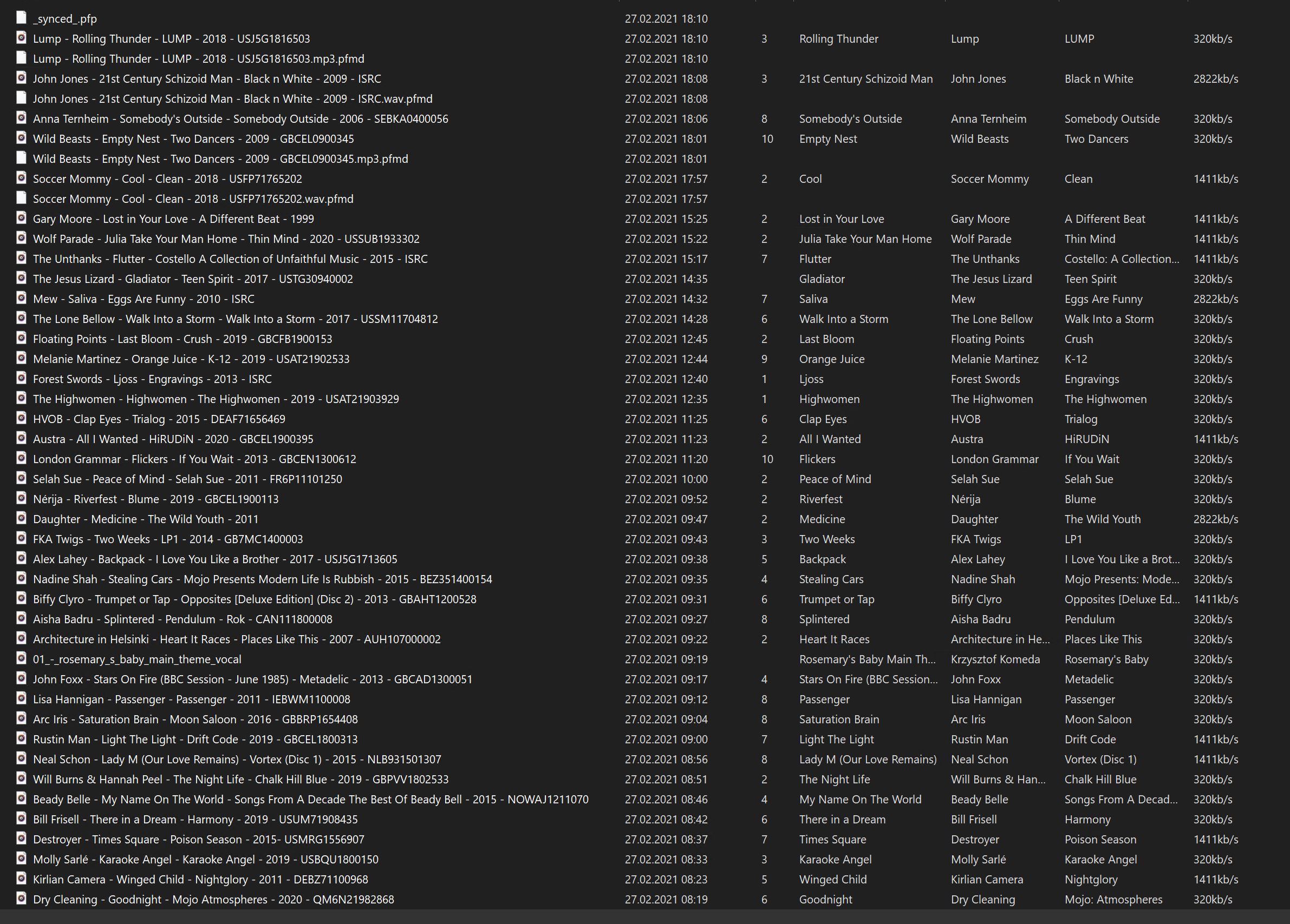

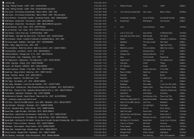

"ProppFrexx also does NOT constantly saves something to the file"
THAT IS NOT TRUE. I uploaded audio files a month ago. And as you may see on attached screen shot the modification date of those files is changing just after the file was played out. So, how magically it is possible?

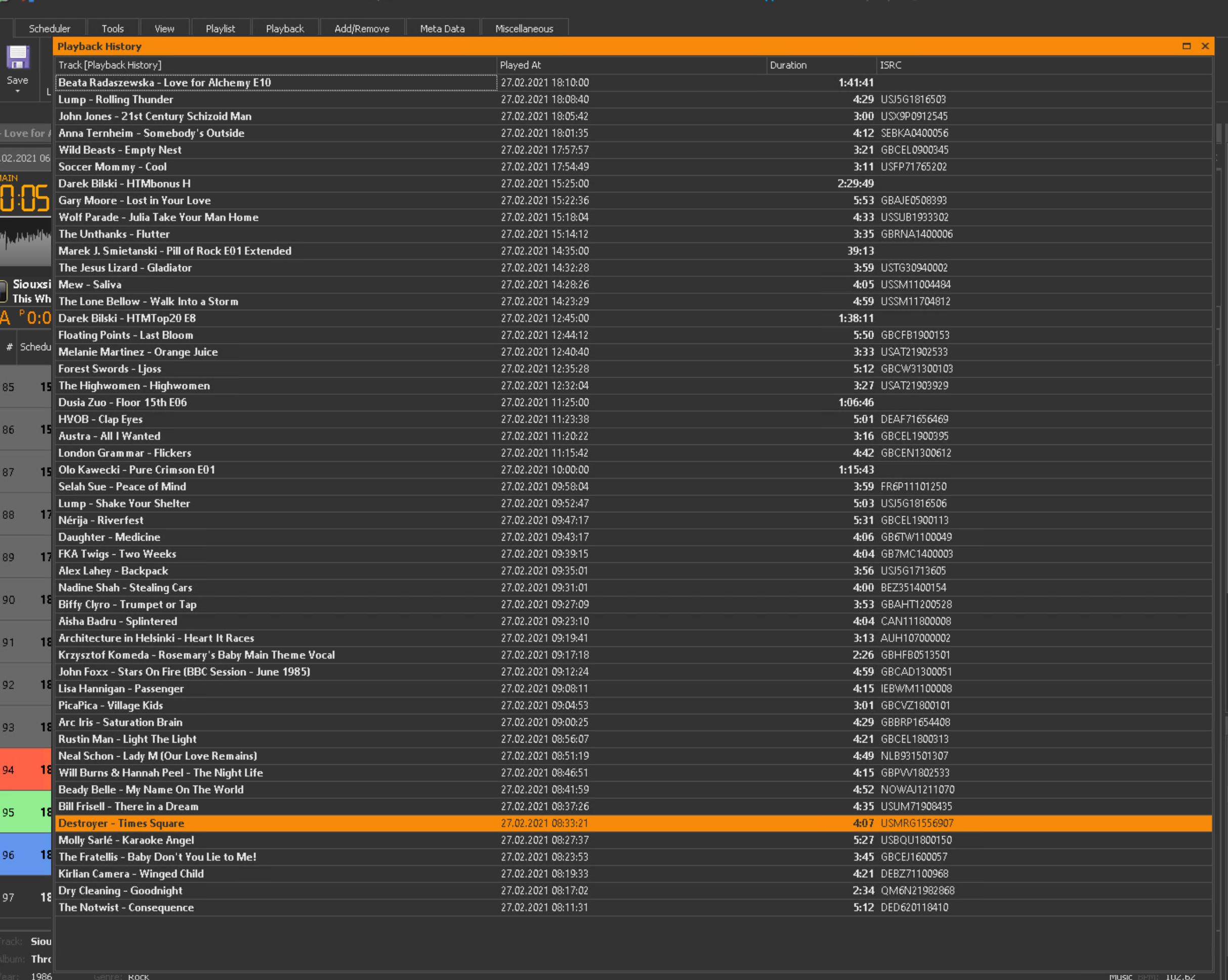

and to prove it... I attached playlist log history straight out of the ProppFrexx.
