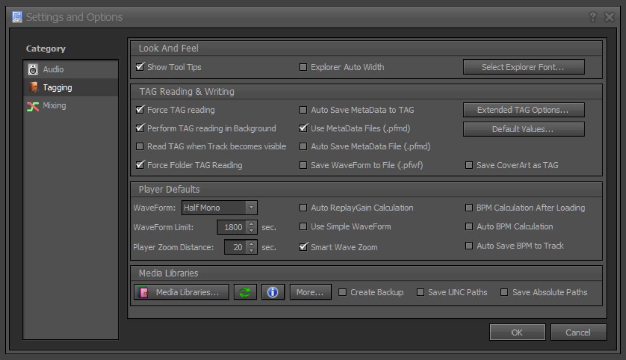

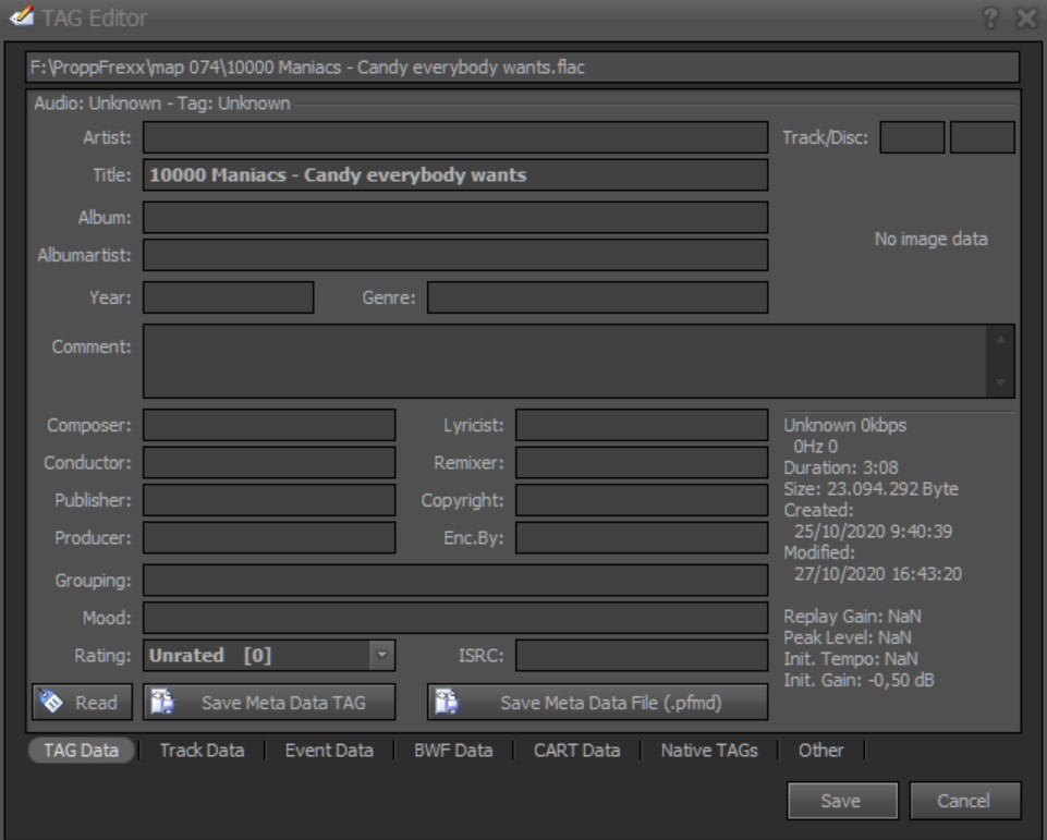

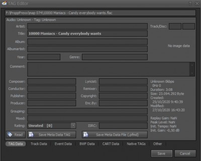

When I open the folder with my FLAC files, the ProppFrexx Meta Data Editor does not read automaticaly the tags. It is possible to selected a group of files and use ctrl+alt+T, then, I see the details.
I played with the options (settings & options/tagging/tag reading & writing), I checked and unchecked every combination of the 4 options in the left column, including closing the Meta Data Editor or refreshing after every change.

In the first row only enable the options ‚Perform TAG reading in Background’ and ‘Read TAG when Track becomes visible’.

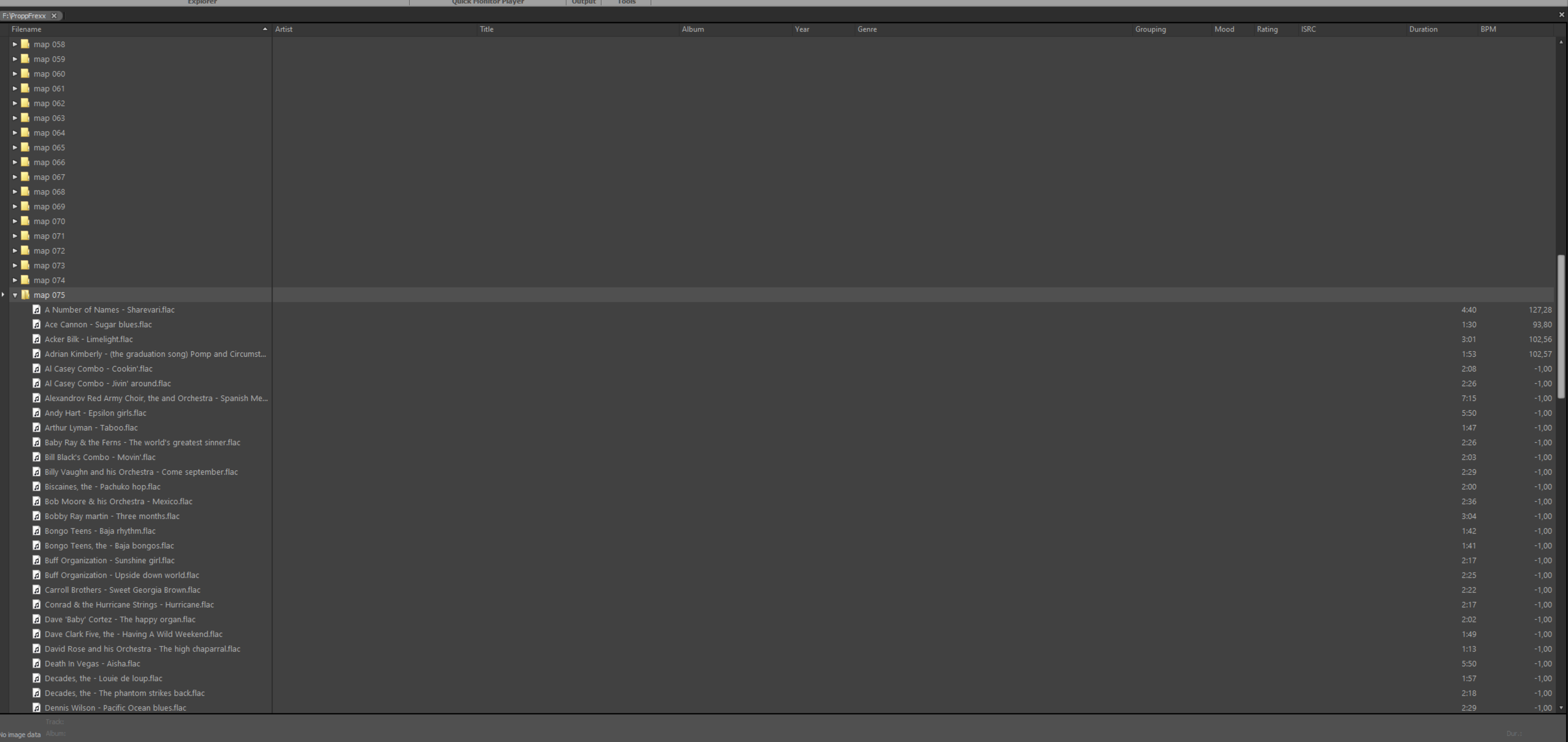

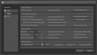

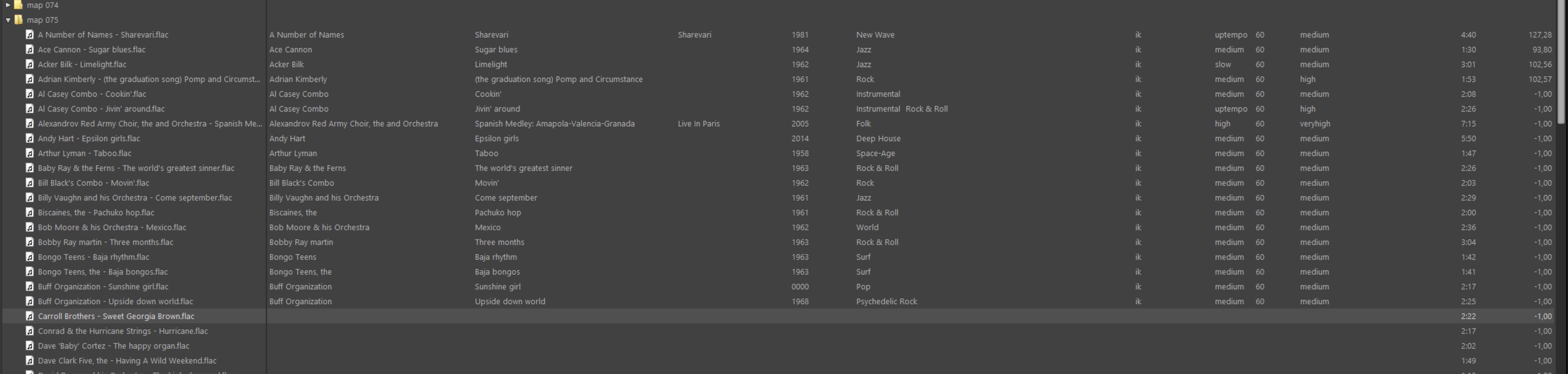

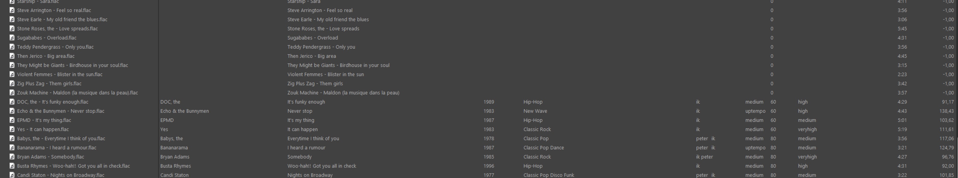

So I enabled 'Perform TAG reading in Background' and 'read TAG when Track becomes visible'. This is the result: As you can see, we are getting ahead: in a random folder with every FLAC file having the same tag field, some of them are read-in and some are not. Funny is now, the Editor refuses to read all of the metadata at some files, although they are all equal.

And if all of those ‘other’ files don’t show anything and looking at the screenshots, it looks, like they don’t contain proper VORBIS tags?
