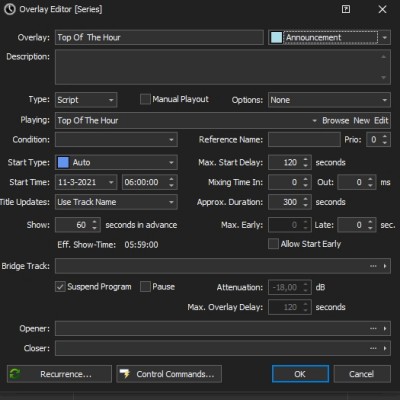

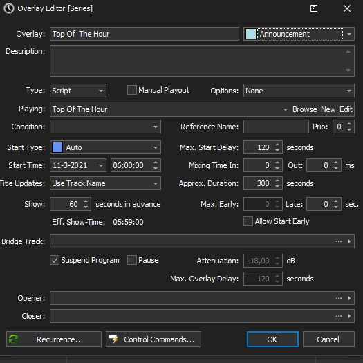

Re: No overlay top of the hour
this is the setup of the TOTH
That shows how it is configured, but doesn’t answer my above questions.
The ‚Auto‘ doesn’t look to good, as it means, that the overlay either starts Soft of Manually depending on the state of the playlist when the overlay is started.
Else, is the ToTH really 5 min. long?
But all this couldn’t be the reason.
Still have you checked my cue-point theory?!
Even no cue-points at all in the last track could be an issue, as then it will be calculated automatically.
So this could be a reason.
