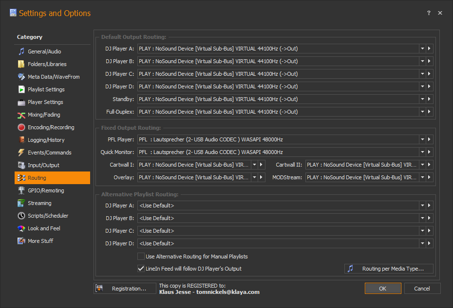

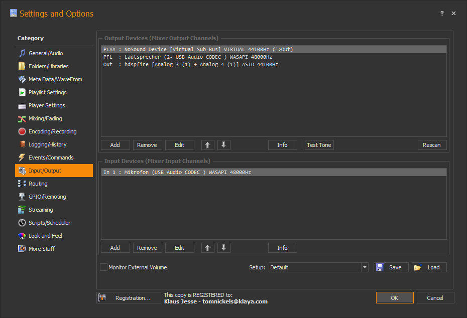

Situation:
1 Mixer = 1 Mic IN CH 1, All PF DJ players CH 2, PF PFL CH 3, USB out total sum to PC which is the IN1 at PF and also used for streaming.
Since the MIC is coming in total with the music streaming, I am not able to voice track because the live stream is messing my track up. So I need to seperate VT from the IN1 I guess but have no clue how to get that done. Any help would be appreciated

Of with just 1 Input you are not able to voice track in parallel. This is physical and logical impossible.
With 1 mixer input channel with which you record your mixer output you can not record anything in parallel.
You need a 2nd mixer input.
And your external mixer needs also 2 different outputs (eG 2 sub busses), one for the sum and one for the Mic only. So that you can switch on the mixer to where you want to rout your Mic.
