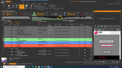

it still appears, that my station name is radio42 while streaming. Where can I change that?

Seems either your initial title update or station name wasn't set accordingly. E.g. here:

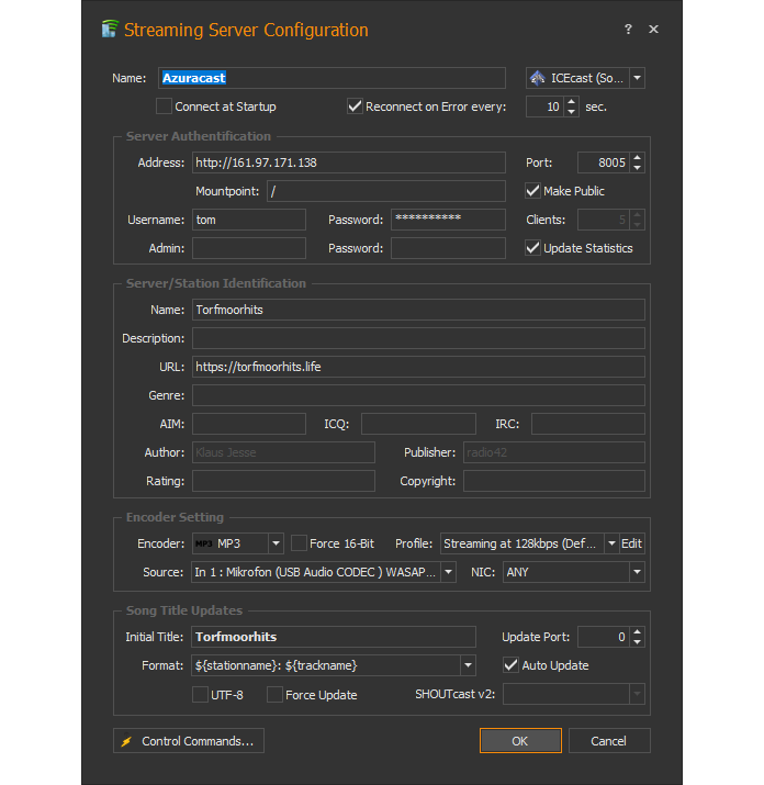

This is what I did and look what comes out also in the station logo window....
Re: How to change station name
Your titloe update forma is: ${stationname}: ${trackname}
So it seems, that you have neer changed your stationame, whoch defaults to 'radio42'.
In your 1st screenshot, just make a right-click in the Station Information window (where you also display the station loge) and select the context menu 'Station Name...' here you need to specify your name in order to change your station name!

Uhhhh that was hidden, but it works now, thank you
