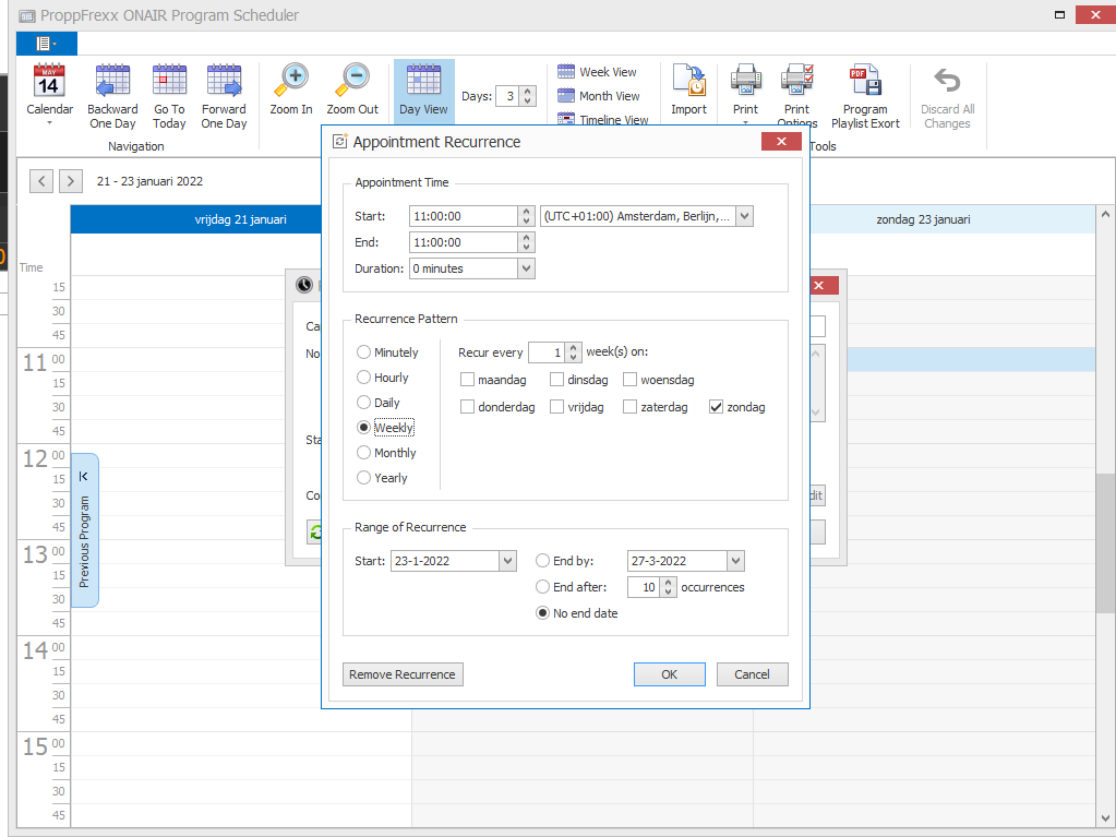

Did you remove the recurrence (or how have you set it?) from the Reminder Alert? Or how did you create the reminder, please send the two screenshots:
definition of the configuration as well as the recurrence.

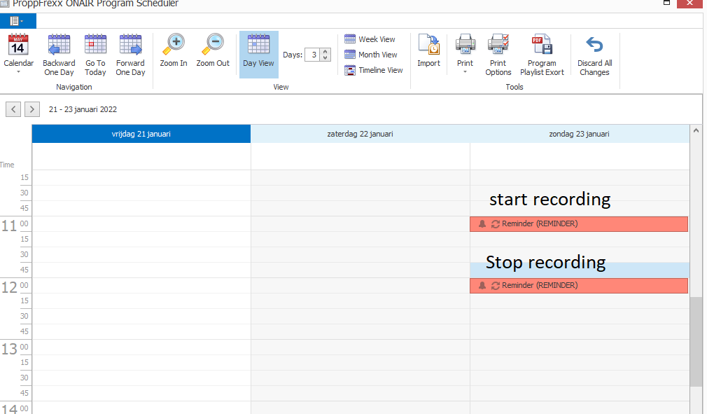

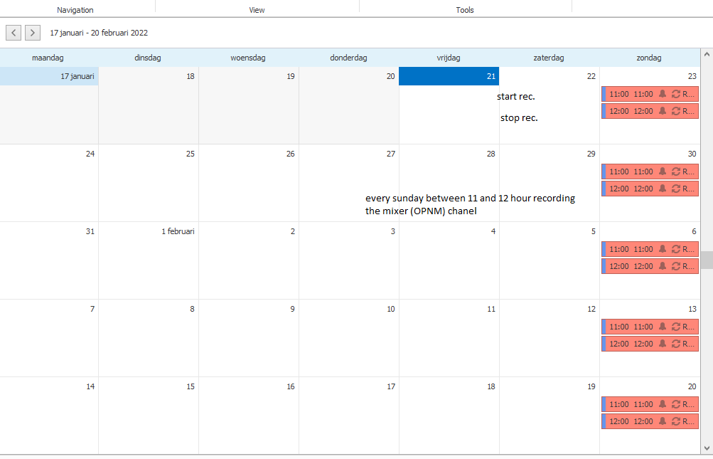

the intention is to use the input signal from the mixer called OPNM to use it to record a recording every week, using a reminder in the program scheduler.
this recording must then be saved in (P:\Replays\Menting\) as wav.
so far as I use this plan as a test today, it also works well, but when I finally start planning it weekly, it does nothing.
I took some screenshots of the planning.

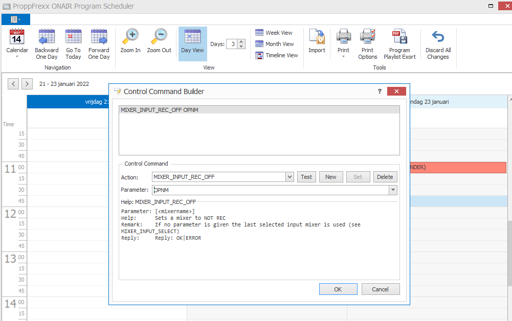

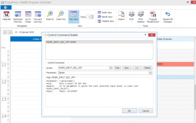

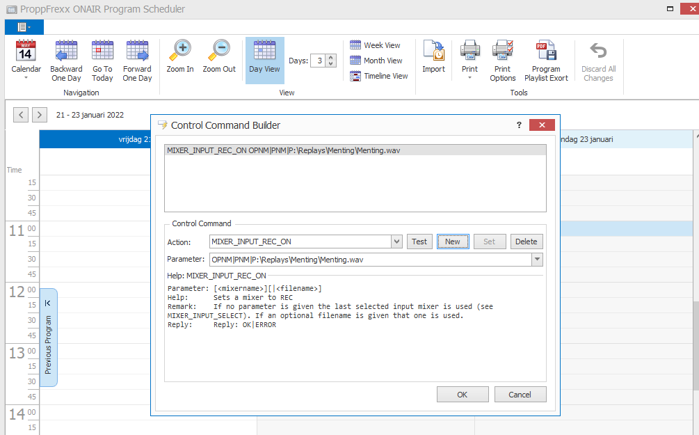

sorry in the start recording there is an error in the parameter this should be MIXER_INPUT_REC_ON OPNM|P:\Replays\Menting\Menting.wav
stop recording
stop recording
start recording
start recording
recourence
recourence

Re: instant recording
The reminders look good.
But it seems, that your _REC_ON command contains 3 parameters, but it should only contain 2!
So please remove the "|PNM" from the command, e.g. it should only be:
