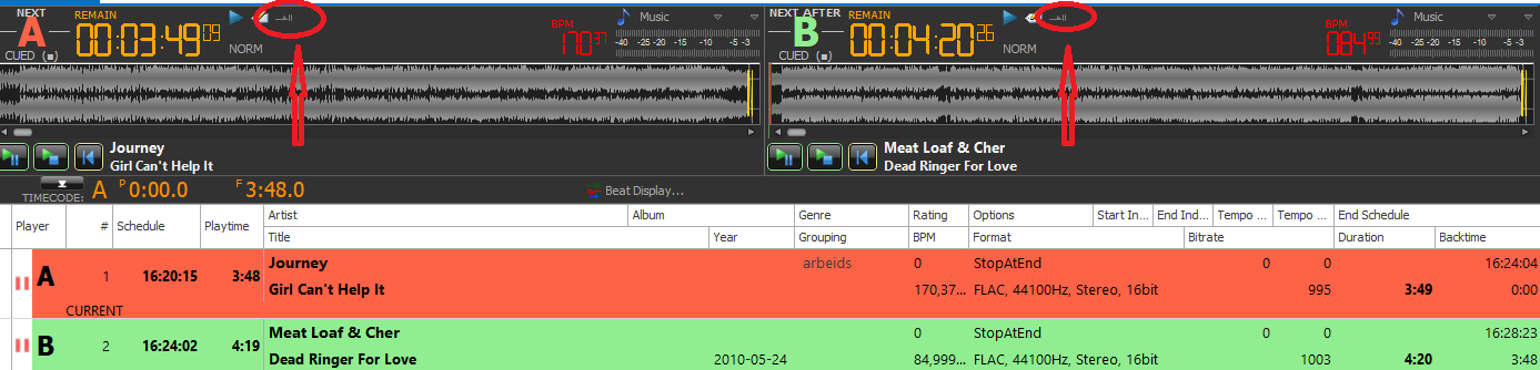

tatje
Posts: 75
Joined: 23 Feb 2013 14:10
Re: Using as live studio playout software
Post by tatje »
it can be easier with On a track, I've right-clicked and chosen "Track Settings" > "Toggle StopAtend option
see picture
click here on Track option
andyb2000
Posts: 5
Joined: 30 Jan 2022 16:15
Post by andyb2000 »
Oh nice, thanks Tatje that's a quick shortcut to remember. Thank you
