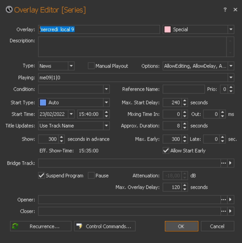

Hi Bernd
what is the difference between early start, late start and max overlay delay ? how do they affect each other ?

When you click on the '?' icon at the top right of each dialog you will get help for each option.
Max. Start Delay:
When an overlay is defined as soft start (so it doesn't have to start at exactly that time) it might be delayed by this maximum number of seconds.
When an overlay is about to be started the remaining time of the current track of the current playlist is checked. If the remaining time is less than this maximum delay time, the track will be played til the end before the overlay is started (which will then result in a delayed overlay start).
But if the remaining time is greater than this maximum delay time the current track is faded-out immediately and the overlay start will not be delayed (except a 'Max. Late' value is defined).
Note: Overlays defined as fixed start will always start on time.
In case of 'EndsAt' this value defines a maximum waiting time til the real effective end. In this waiting time a given 'Bridge Track' will be played looped!
Max. Early:
If the overlay is allowed to start early, this value defines how much early it might start (in seconds).
When set to 0, the 'Show in advance' time is used (as such, this value should be less).
Note, in case of EndsAt, the effective end time might be early! In that case you should specify a 'Bridge Track', which is then played looped until the 'Max. Start Delay'.
Max. Late:
If the overlay is allowed to start Soft (or EndsAt), this defines how soft it will start.
Setting the value to 0 is the default, which means, it starts at the end of the currently playing track, if its remaining time is less than the 'Max. Start Delay' - else it will start early immediately.
If the value is greater than 0, the overlay starts at latest this number of seconds late. This means, the 'Max. Early' and 'Max. Late' time frame define the soft starting time range and a currently playing track is at least playing this long and is only started early if it ends in that range - else it is started this late.
Note, in case of EndsAt, the effective end time might be late. In case a 'Bridge Track' is given AND the 'Max. Start Delay' is NOT reached yet, that bridge track will be played looped until the 'Max. Start Delay' is reached.
