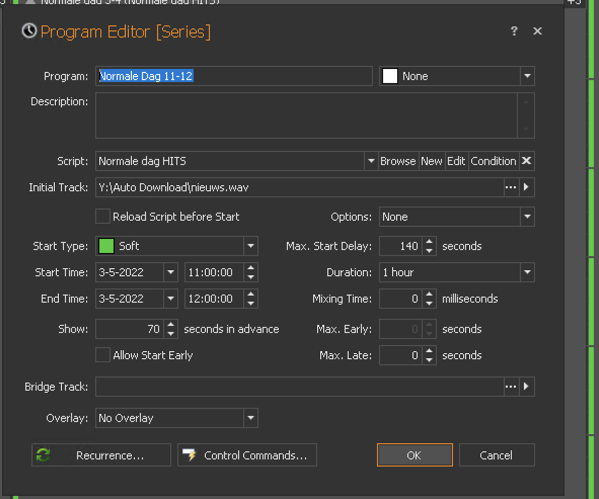

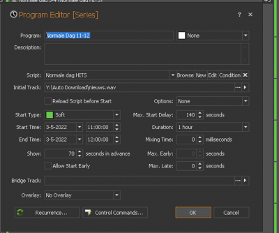

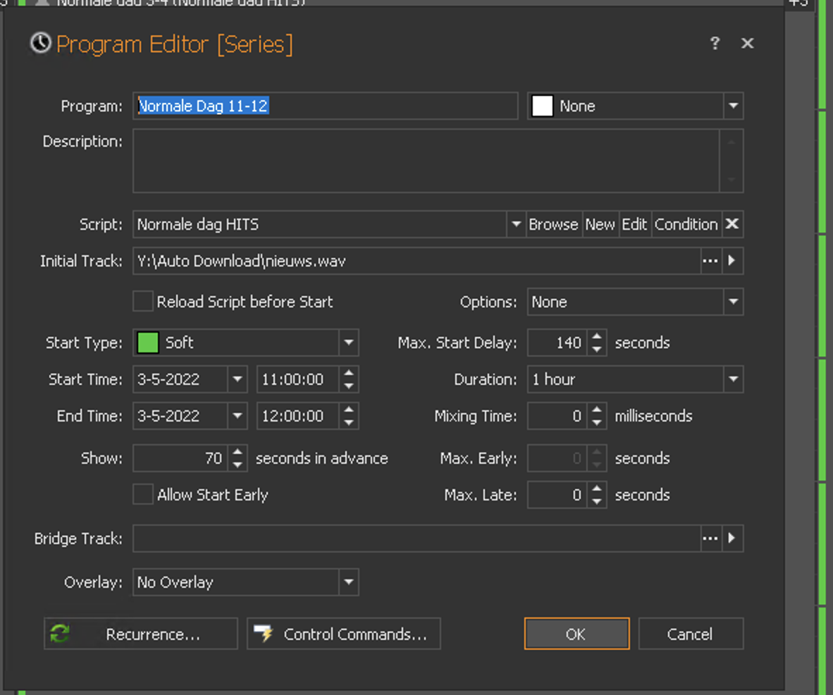

I play it like this. As this file gets refreshed (every hour, xx:56), and my playlist at the full hour, I dont think the file gets changed while the playlist is open already.
I can also see that the file gets changed (probably by Proppfrexx) at exactly the whole hour, so not xx:56.
Is there anything else that you can recommend?

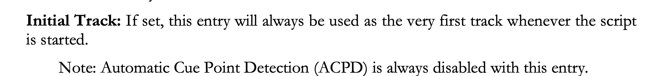

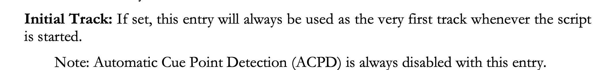

Is the documentation incorrect? See attached screenshot.
When it occurs again, I will find some ways to get it reproduced - otherwise it's undoable for you.
