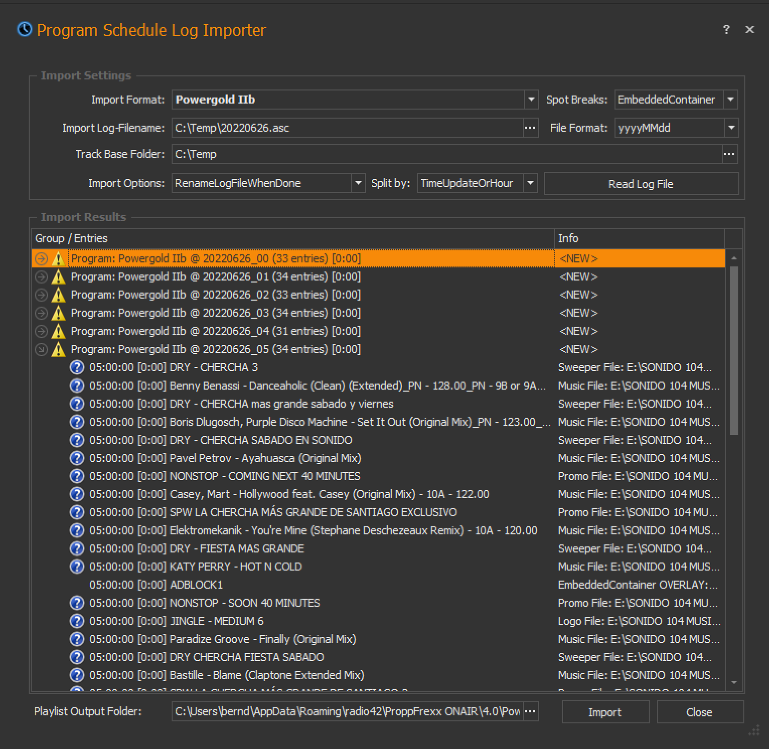

Seems, that all your filenames could not be resolved as audio files?! Eg. the path in the log file is not accessible (E:\…)?
This also leads to the fact, that every is seen as a Document Entry with a zero (00:00) length.
So please check your file path and location.
And...
you probably imported a different log file with different/wrong data. I just imported the log file you provided above and that perfectly worked (obviously the duration of each entry is still 00:00, a it couldn't resolve the correct audio files, but the hour splitting worked like a charm):
