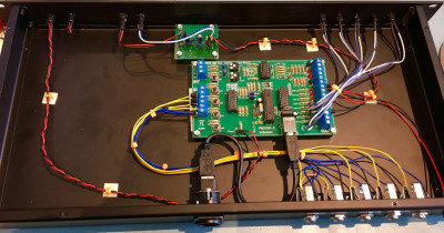

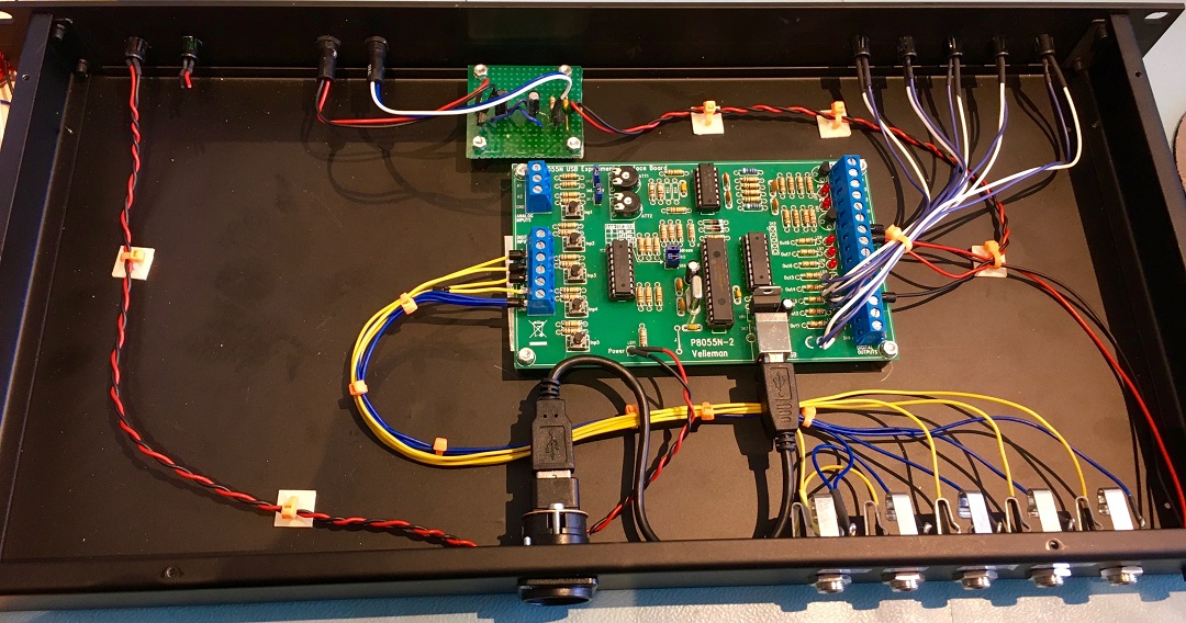

another question, I'm building new event librarys up, but there is something that won't work, I designed a 19" case with a K8055n card in it.
I have for each channel a led, that has to burn when, let us say, pin1 is on. Because the card is bi-directional via USB. I'm assuming there is a way in Propp to give a commando, to light up the leds? How do I make these commands, if possible?
thanks,
Gunther
Re: GPIO client (Velleman) Scripts
You can use the EXEC_SEND_VELLEMAN control-command with e.g. the parameters card|pin|state to send an output-port state change to a Velleman card.
The card must be between 0 and 3; pin(1..8) and state(true, false).
Example:
EXEC_SEND_VELLEMAN 0|1|true
