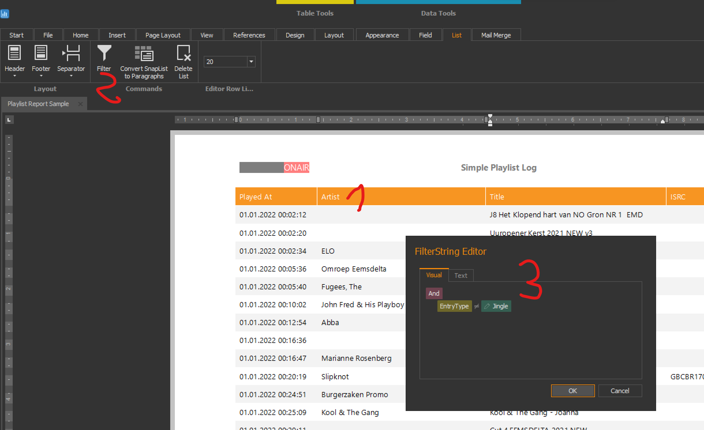

I've run some stat reports and am trying to remove a media type (jingles) from the report in the snap report designer but can't find a way to do this.
Can someone please advise? I've watched the Report Designer video but alas I'm still unable to figure it out.

When you open the Snap Designer...
1. click into any column header
2. go to the List tab and click on the Filter button
3. specify your filter condition
(like shown in this screenshot...)

As per usual, bang on the money 🙌🏾.
Many thanks.
