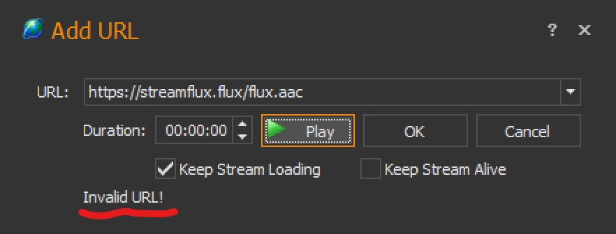

Re: LoadTrack + remote stream
The given URL is invalid!
I.e. test the url in a web brower - or try to add that URL address to a playlist:
However, one it is working, you can add one of the two script-line options:
The 'KeepStreamLoading' option is used BEFORE player is effectively started and the 'KeepStreamAlive' option is used ONCE playback was started.
So if you want the behavior you described (and in any case advance the stream even if disconnected only manually also during AutoPlay), you need to set BOTH option.
Keep Stream Loading:
If the entry is loaded to a Player but the stream is at this point not available, the player tries to reconnect until the stream becomes available or until you manually advance to the next track.
Keep Stream Alive:
If the entry is played within a Player and the stream disconnects during playback, the player tries to reconnect until the stream becomes available again or until you manually advance to the next track.
But...
finally, I assume you don't want to have silence on air - so if the stream is not available (for whatever reasons) it will skip that script-line.
