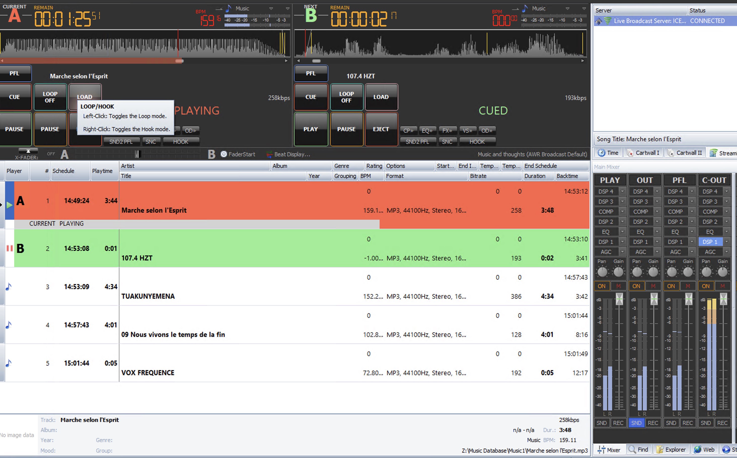

Using the latest build of ProppFrexx I have noticed when switching to different lighter themes the mixer and decks remain dark no matter what style is selected, and end up with a mix of light and dark.

This is/was always the case with every version (not only the latest)!
The main reason is, that the peak level meter cannot be themed. As such the DJ Players as well as the main mixers are always dark.
