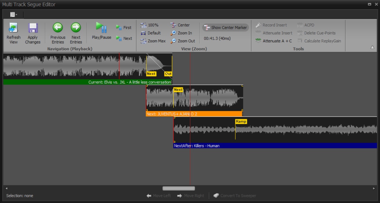

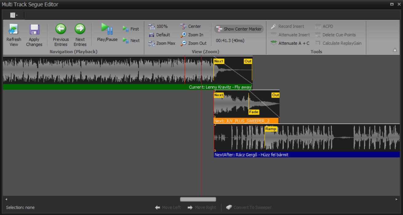

I really like the options "Insert Track Transition but (maybe I'm wrong and just can't see it) I don't find a very useful transition.
And it would be a real insert, more how this logic override temporary the cue points in the Playlist for the selected files.
Logic:
Is there a Ramp for the next track:
- No: No transition = play the item as an individual track from the Next cue point of the next track (keep as it is, no transition)
- Yes: Next Song's Ramp is equal or grater than the "Insert track" length = Play the "Insert track" from Cue In point (or the previous track Next point - same)
- Yes: Next Song's Ramp is less than the "Insert"" track length = Start Playing the "Insert track" with the previous song Next cue point and Start Play the next song the (Ramp length - Insert Track length).
Here is some examples:
Ramp is Longer:
Ramp is shorter:

The "Insert Track" length always means between Cue In point and Next Point, not the full length of the track.

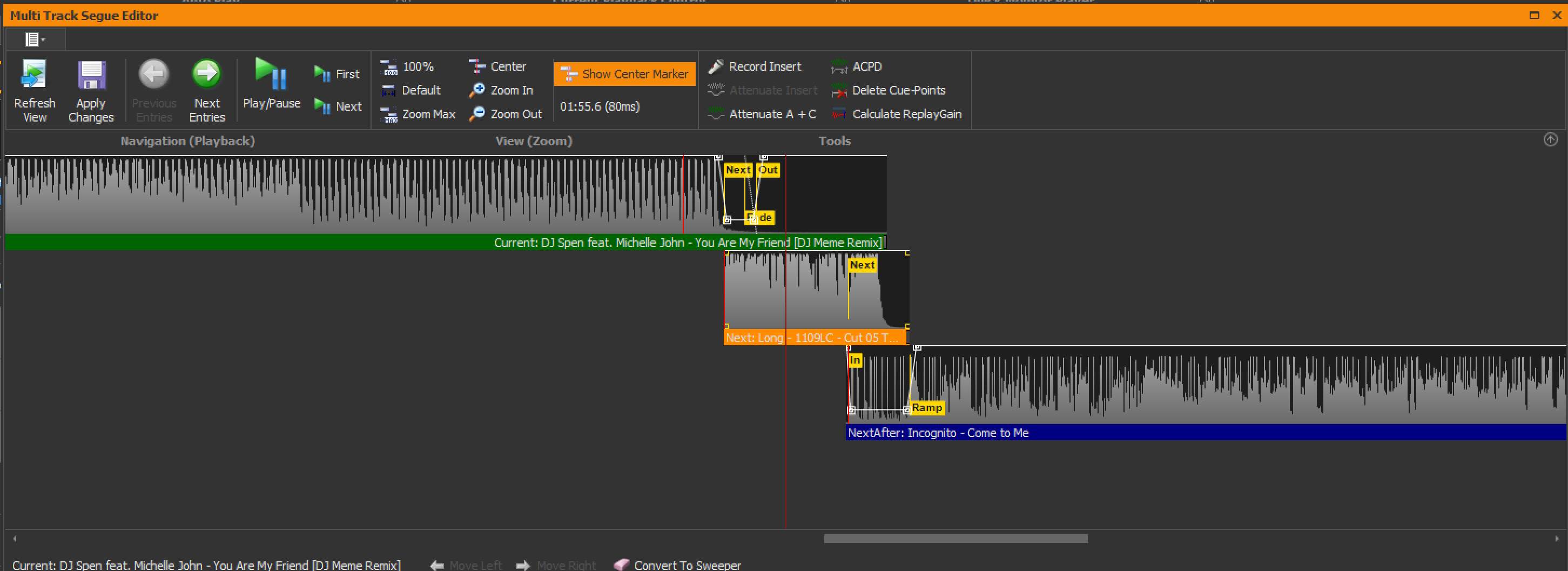

Here is an example I was just creating with the "VO: Start with CueIn or End with Ramp of Next Track"
The Insert Track is longer than the Ramp time. I.e. this exactly matches your condition:
Next Song's Ramp is less than the "Insert"" track length = Start Playing the "Insert track" with the previous song Next cue point and Start Play the next song the (Ramp length - Insert Track length point). - second screenshot in my previous post.
So this is does exactly what you require:
a) Start Playing the "Insert track" with the previous song Next cue point - DONE/OKAY
b) Start Play the next song the (Ramp length - Insert Track length point) - DONE/OKAY
Can you explain me in the above example - what you believe is wrong here?!
