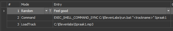

I am creating a script in ProppFrexx script editor:
This script looks like this:
#2 is a self created python script that creates an MP3 file used in #3
I would like to use the trackname of #1 as parameter in #2

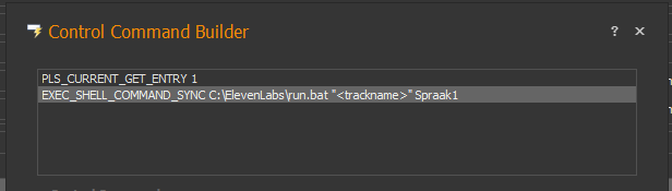

My plan was to use the command PLS_CURRENT_GET_ENTRY to get that information
But how do I use the result of PLS_CURRENT_GET_ENTRY in EXEC_SHELL_COMMAND?
It is possible I am thinking in the wrong direction here, if you have any better suggestions it would be greatly appreciated.

First note, that a script-line is executed when the line is executed and NOT when the track is played. I.e. when a new track is requested from the playlist to be schedled to a playlist - this is sometimes timing wise 3 tracks ahead of its play time.
Regardless, the _GET commands are typically designed for external applications to query a result.
But internally they can not be used to retrieve a result.
For this you need to use script macros. On this case the "*[EXEC:{controlcommand}]" macro.
This macro actually returns the reply of a control-command.
For example you can omit your 2nd Command script-line and instead use the macro in your 3rd LoadTrack command, e.g. like this:
LoadTrack, C:\Elevenlabs\*[EXEC:{EXEC_SHELL_COMMAND_SYNC C:\Elevenlabs\run.bat xyz}].mp3, Count=1
This assumes, that the batch returns xyz and not the extension - that's why I added .mp3 as well.
