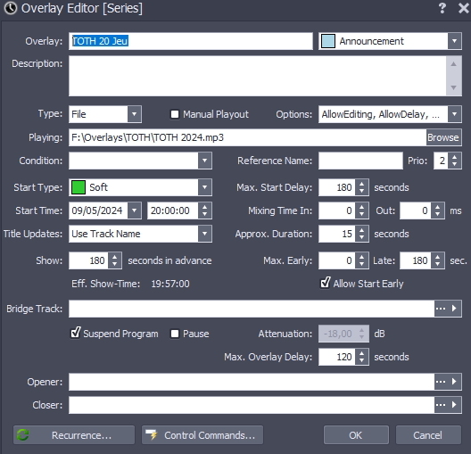

I reviewed the content of the "?" and according to the only section where mixing time is discussed, my settings are correct: 0 for Mixing Time In and 0 for Mixing Time Out as you can see in the image. In fact, I understand that with each overlay diffusion, PF systematically mixes the current track with the overlay. However, it is explained that "Set to 0 to start the overlay with the 'Next' cue-point of the current track of the current playlist."
On the third and final part of the show, I didn't set a 'Next', just an 'Out' without a fade because the show ends with a speech. Could that explain the issue?

When does/would the last track of your series end?
If it would for example end at around 20:03:10 or even later… it would violate the ‚Max. Late‘ condition and the last track would be faded out before its natural end.
I just also tried exactly your settings and let the last track finish just 70 sec. later than the overlays start time. And here the last track fully played til the end with no fading… and after the overlay started.

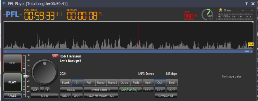

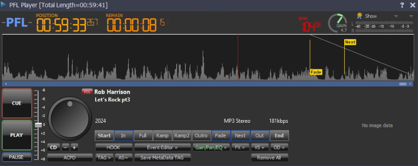

Actually, I saw live what's happening and it's a very strange behavior: when it's loaded and starts playing, PF adds a Next and a Fade at the end of the 3rd file, whereas originally there isn't one. Since I was able to remove it during the broadcast, the transition between the end of the show and the toth went ok.
Before launching
After
Before launching
After

Make sure, that you have NOT set the 'RecalcACPD' script-line option!
You might also set the 'SuppressACPD' option instead to be sure, that the cue-points are not changed automatically.

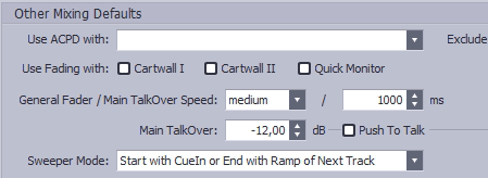

I checked, no RecalcACPD and regarding SuppressACPD, as it's a playlist, I don't have script options.
But about SuppressACPD, I have a question: I understood that it doesn't add cue points, but does it keep the ones I created?
Also, I think the issue comes maybe from this setting "Use ACPD with" where the DJ Player and Standby Player boxes were checked. What do you think?
