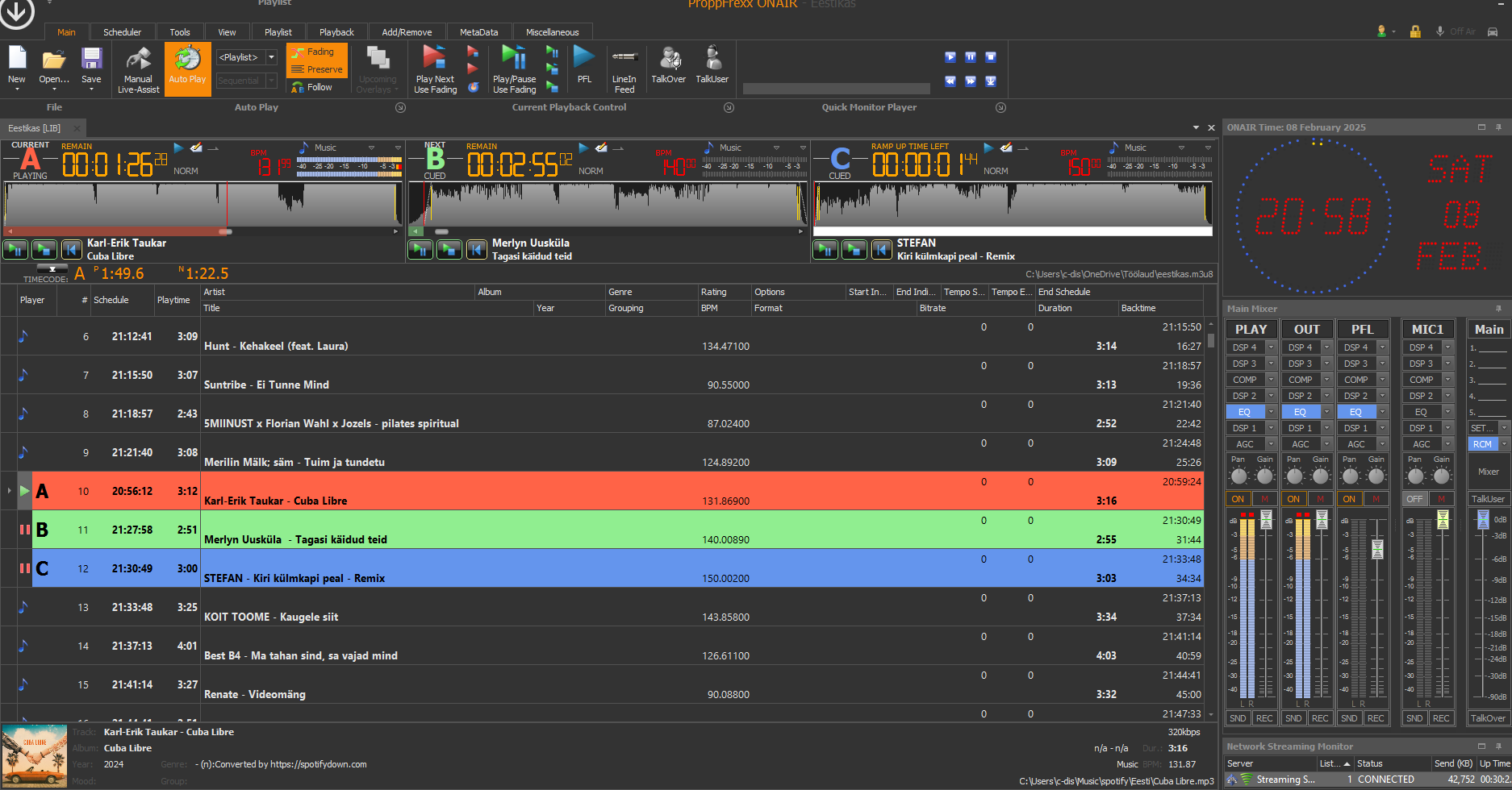

I have a playlist taken from Open - Media Libraries. Now I want my radio jingle, which announces my radio's name, to play after each song. I'll attach an image.

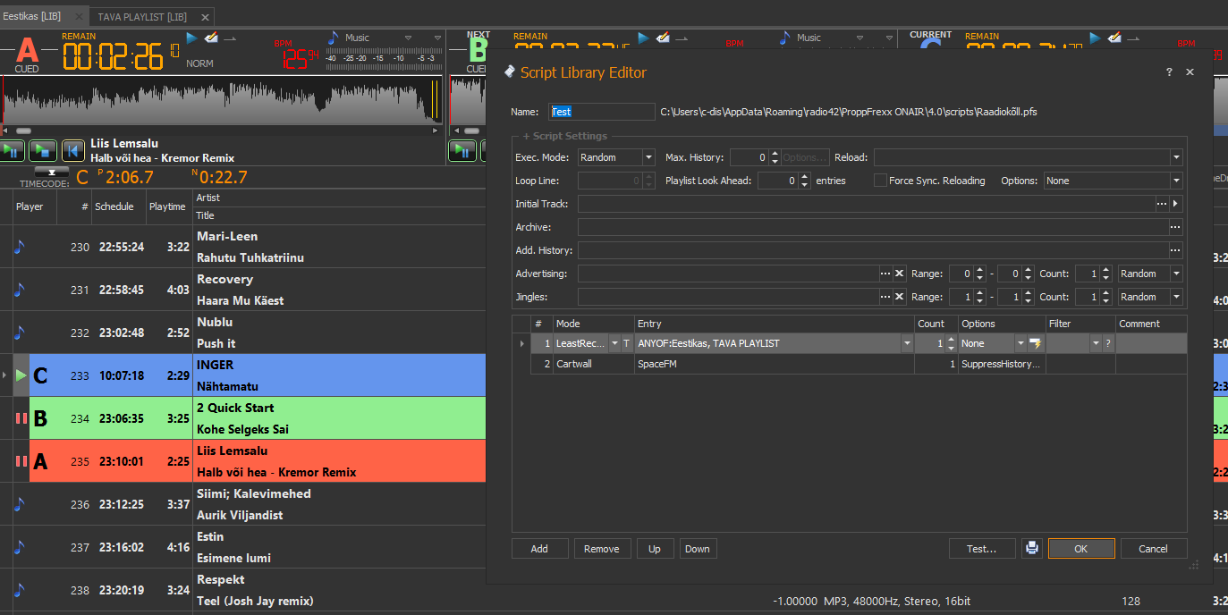

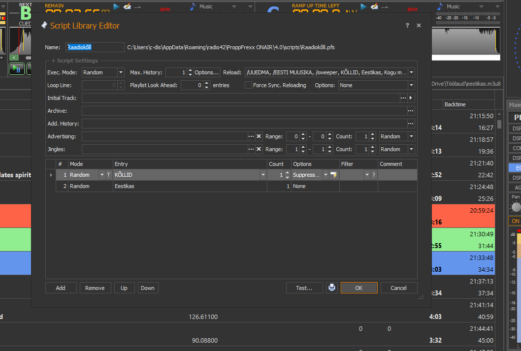

Additionally, there's an image showing my attempt to create a script, but I don’t fully understand how to configure it so that the jingle plays after every song.

Set the script to Sequential Mode (not to Random).
Note, that when the script is executed its script lines are looped (by a playlist which was generated by a program scheduler entry; ie. for a program you define a script to be executed; ie. when the program is started, a new playlist is created and the script is executed for that playlist until the next program is started).
You can now define (as the simplest) script just two script-lines:
1. LeastRecentlyPlayed, YourMusicMediaLib, Count=1
2. Cartwall, YourJingleLib, Count=1, SuppressHistory
That’s it. The first script-line retrieves the Music.
The 2nd script-line retrieves a Jingle.
After that, the script is looped… etc.
So the tracks returned by this Script is always: Music, Jingle. Music, Jingle, …
The global history settings are used for the first entry (no further options are set). The global history can be defined in the general settings. Start with all default values.
For the 2nd script-line the history is suppressed (as you typically don’t have that many jingles) - so just a random jingle is selected.
Note, that this is also the difference between a Media Library (which contains Music) and a Cartwall Library (which contains Jingled, station logos etc.).
Also note, that you can Test scripts. See the Script Library Management.

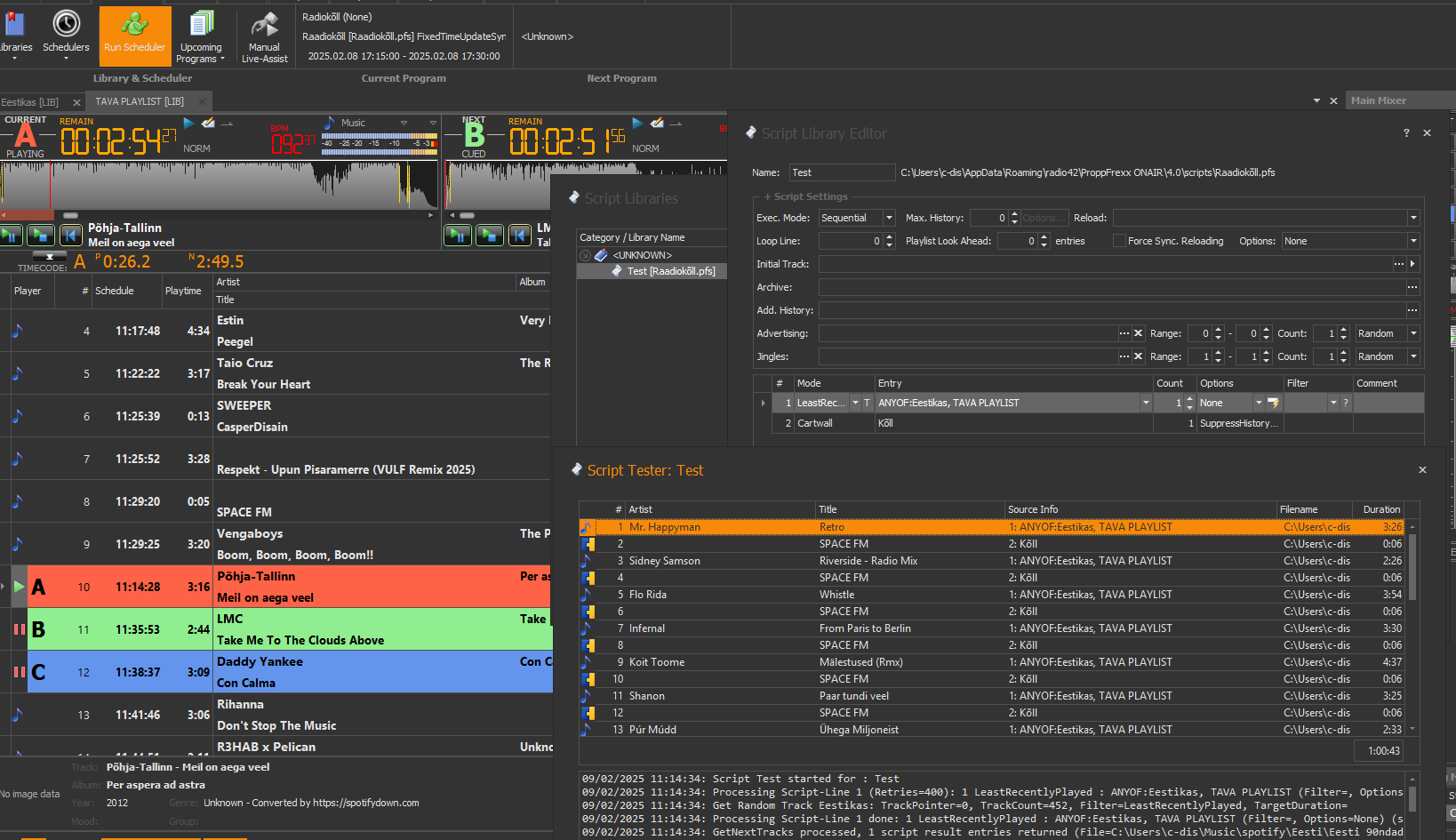

Okay. Anyway, I did a TEST, and it shows everything seems fine, but my jingle is not played after any song. Why is that, or what could be wrong? I could even pay you if you help fix it via TeamViewer! 😊
