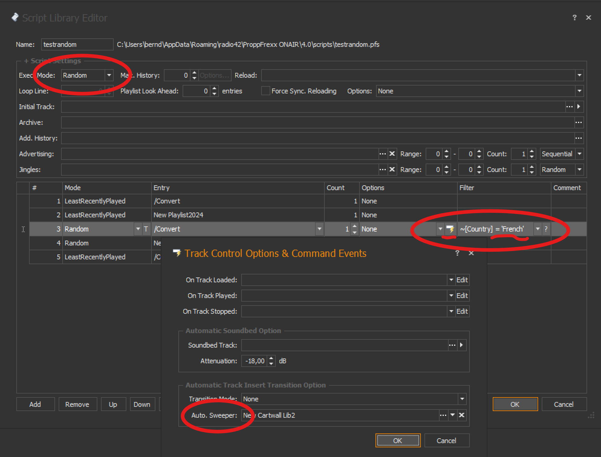

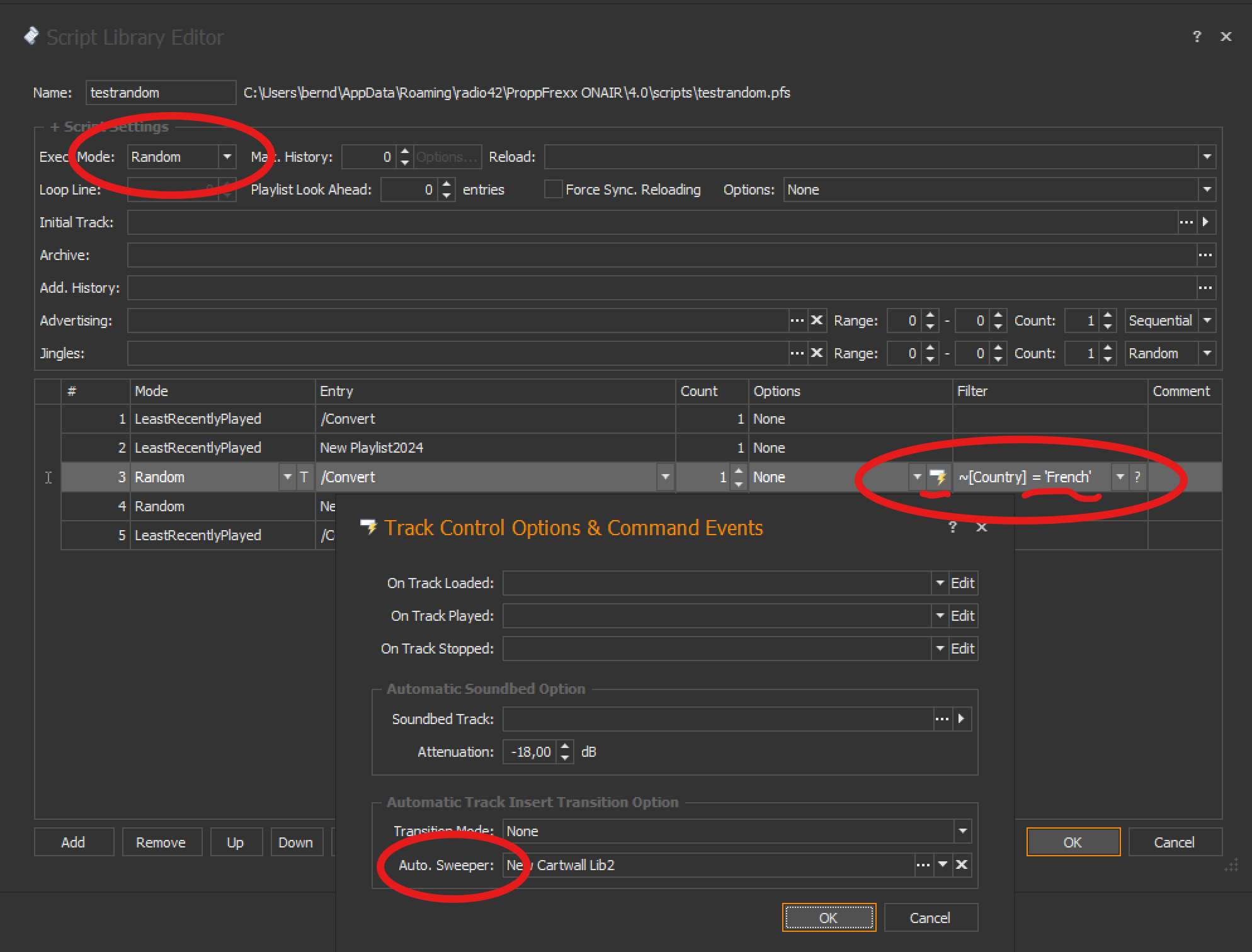

Dear
would it be possible to randomly play a French or German or Oldie in script.
Preceded by a jingle that also includes: Time for French or German or classic.
So this is random, how do you set this via filter
French jingle en next is a French song.
German jingle and next is German song. This would be played random.
For example, we don't want a French song every day at 8:30 am.
This should play randomly.
How do you link a random cartwall category with a random media library category in a script?
The media type in Cartwall should be the same media type from Music Libary.
Thanks for the advice!
Posts: 9232
Re: Play the same media type in cartwall and music libary
If you want them to be randomly played, set the script mode (not script-line) to Random, so that the script-lines are executed in random order.
Define one script-line with:
1. a filter for the country (see the Filter column)
2. set an 'Auto. Sweeper' for that script-line to link a cartwall entry with it (click on the small arrow at the end to specify more sweeper options)
Note: Make sure to have the latest v4.5.0.4 installed to enable the find and filters for the new Gender and Country tags.

Ok thanks in advance for the opportunity.
And can you prevent your jingle from playing on the intro of the music? The Jingle may not play like a Sweeper.
Thanks for the help.
Would it be possible to select here not to play the intro or ramp? Or is there another way please?

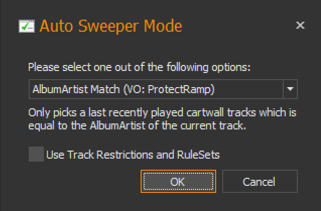

Posts: 9232
Yes and No, that is the only option.
But, as said, you can click on the small arrow to further set additional Auto. Sweeper options. E.g. the "AlbumArtist Match (VO: Protect Ramp)" option.
Any 'VO' option will keep the 'Sweeper' as an extra track in the playlist.
Jeroen R
Posts: 66
Joined: 25 May 2023 10:44
Post by Jeroen R »
It worked! Beautiful, thank you in advance!
