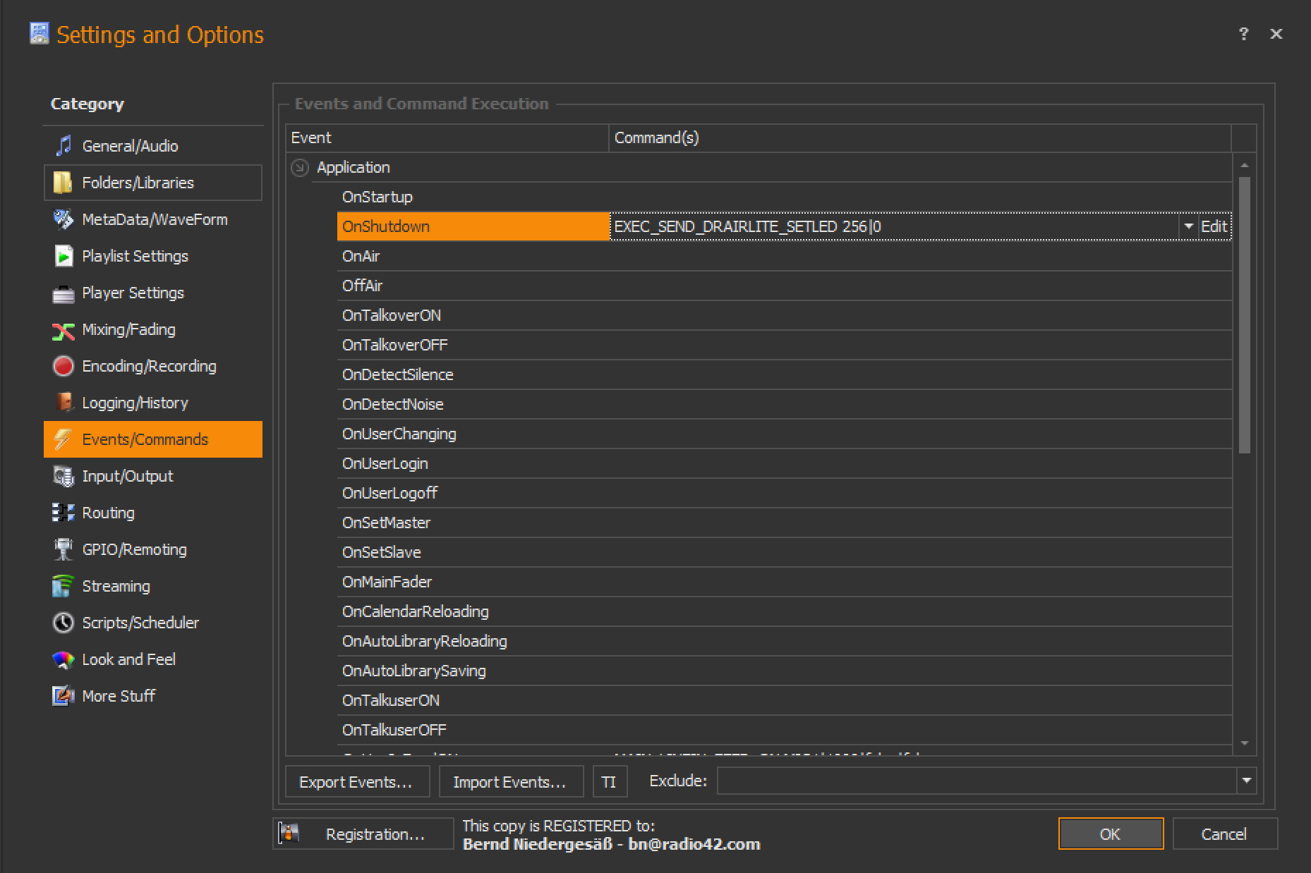

can you give me a tuturial how to set this on the closedown of propfrexx on air is this in the event page

okay when i do that its not Turning off the lights
Posts: 9160
Re: D&r airlite Cartwall Lights will not turn off after closting program
I will check, if at that point the connection to the GPIO Client is already cut/closed.

radio42 wrote: 08 Apr 2025 07:13 I will check, if at that point the connection to the GPIO Client is already cut/closed.
its on and when i close the program i see GPOI client Connection Disconnected
Posts: 9160
You can not see, if the internal GPIO processing within PF is already stopped. This is happening async and it might be, that the internal connection is already closed when the asyc task to the GPIO client gets processed. I will change to a sync processing for the Application.OnShutdown event in the next version.
You can define a user command (e.g. Custom.OnUser1) for now to turn off all lights on your D&R.
