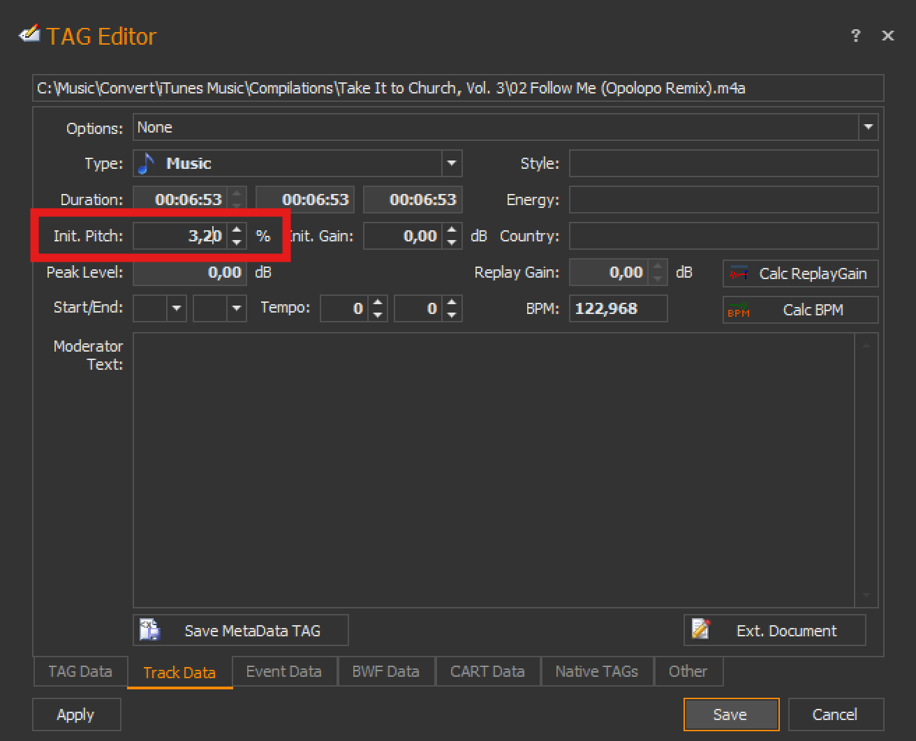

And as said. This is possible in ProppFrexx already. You can set the initial Tempo of a track - ie. to play it faster and perform time-stretching. Eg. see the TAG Editors Track Data tab. The field is called Initial Tempo.

Sorry, it is called "Initial Pitch" in the TAG Editor:

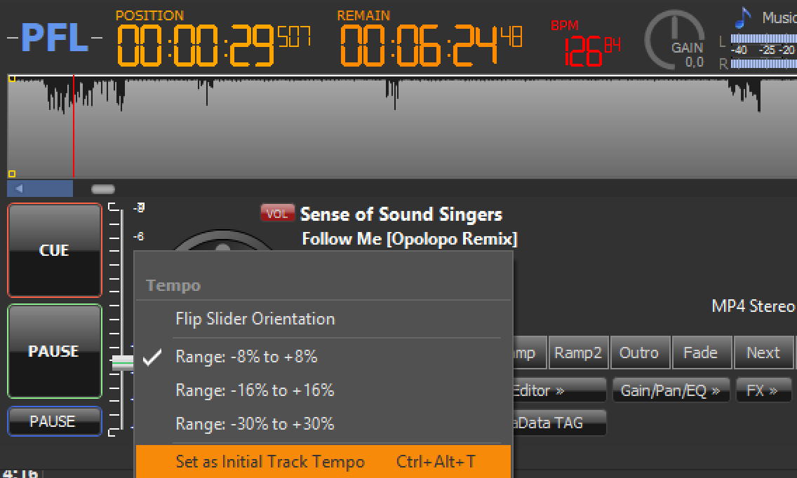

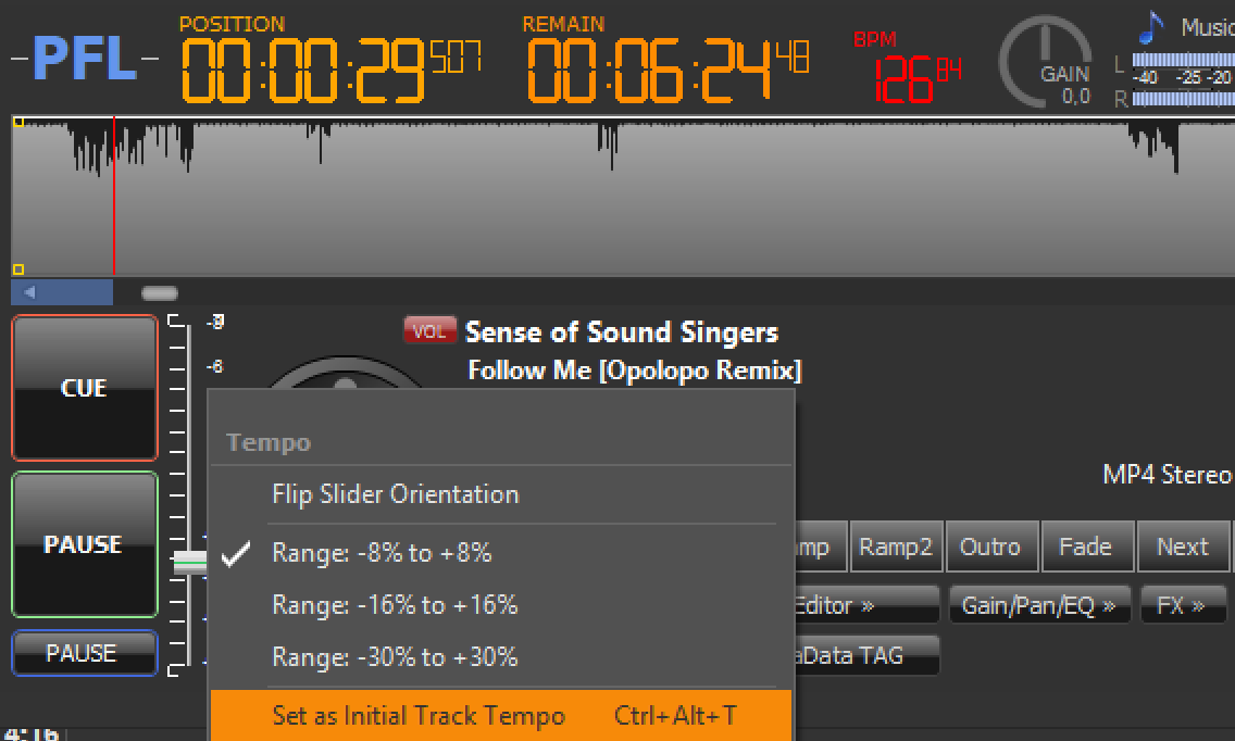

In the PFL Player you can also right-click on the Tempo Slider and select "Set as Initial Track Tempo" - it is the same:

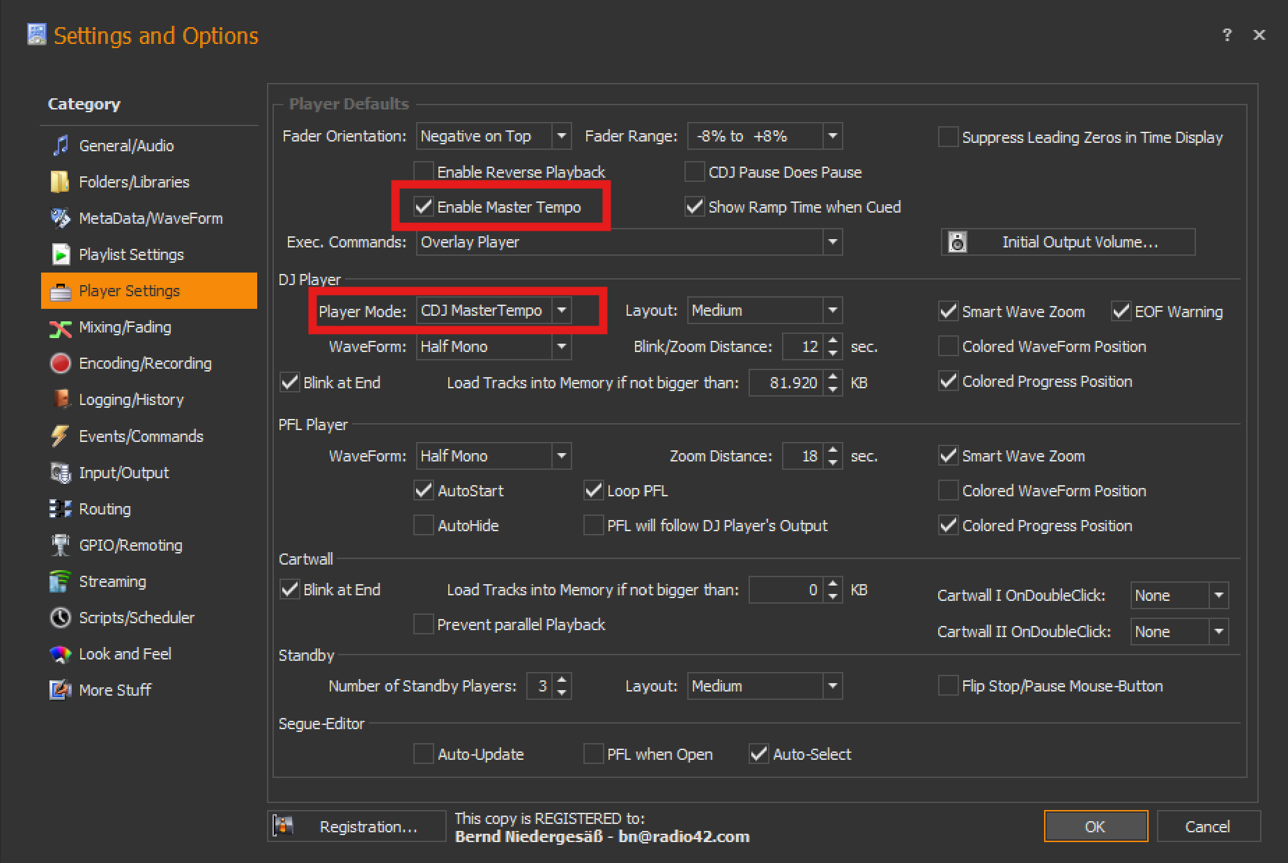

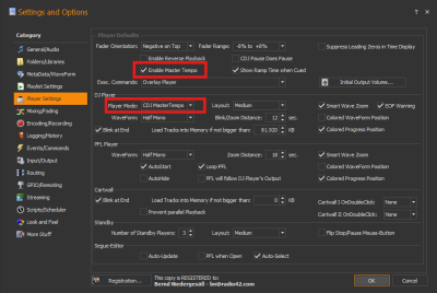

By default Master Tempo is not enabled, i.e. changing the Pitch/Tempo would also change the Key - this is like changing the sample rate or playing the track faster/slower.
If you like to preserve the Key while changing the Pitch/Tempo you need to enable Master Tempo and also set the DJ Players to MasterTempo mode (MT). These two settings needs to be applied for that. Note, that these changes are non-destructive to the audio track (ie. they are applied in real-tme and consume more CPU, depending on your system probably not really noticable):

Re: Reducing audio file length
As you said, I have enabled Master Tempo and set the DJ players to MasterTempo, but the key is still changed. Do I have to restart PF after made these changes?
No. But you have to open a new playlist window…
