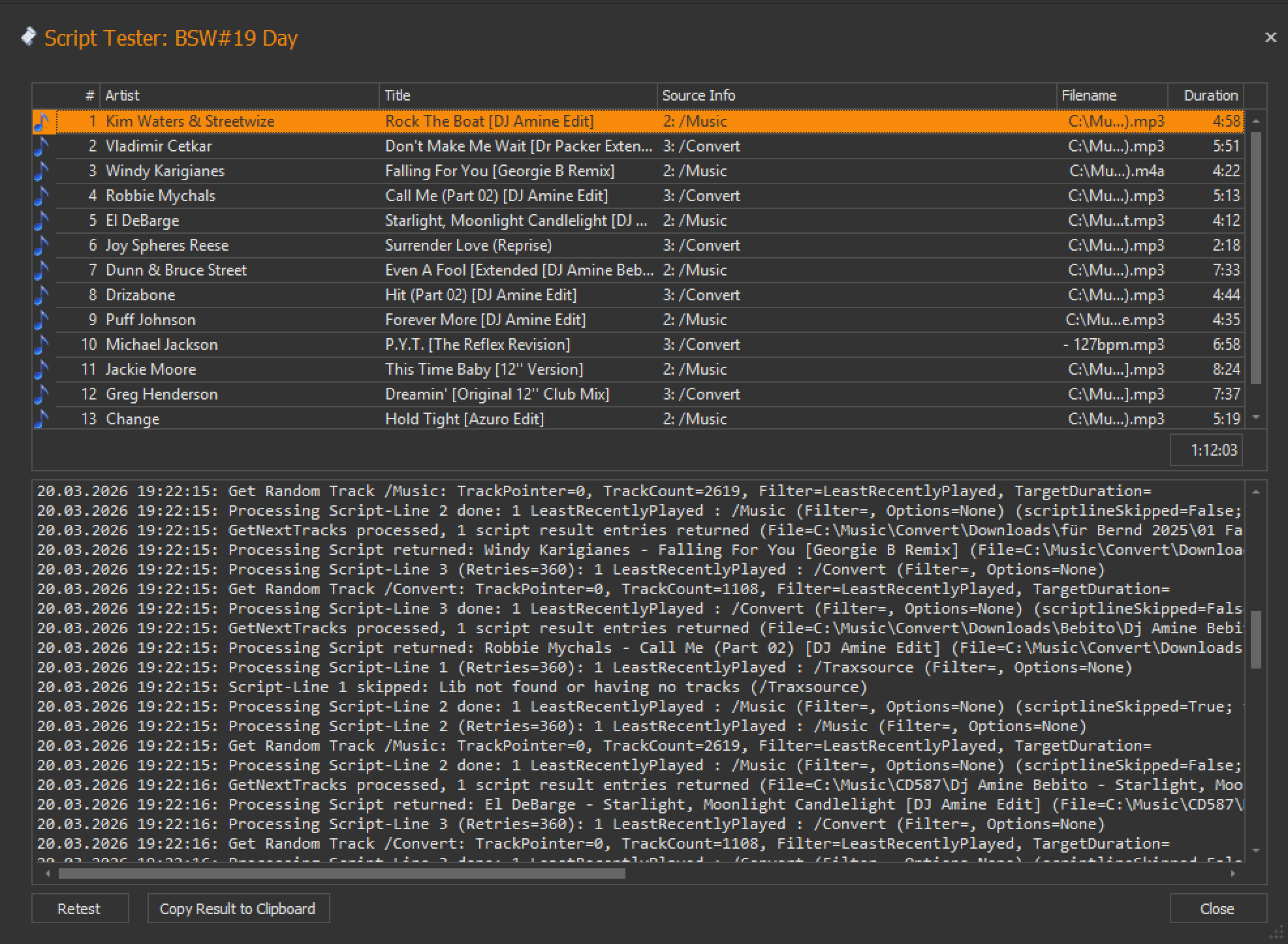

The "Test..." function always produces an output - so it is impossible 'nothing pop up'.
The full output in this window (bottom part) is interesting...

That log returned script entries / tracks.
As you said, it seems, that it only under certain conditions produces errors resp. has issues.
So this is indeed hard to measure it tell from here.
So you would need to monitor it when you discover the error. I assume it is a history issue.
