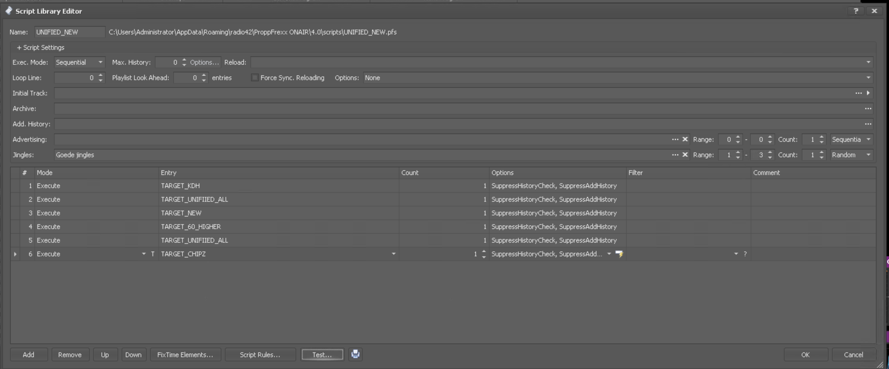

Hi there,

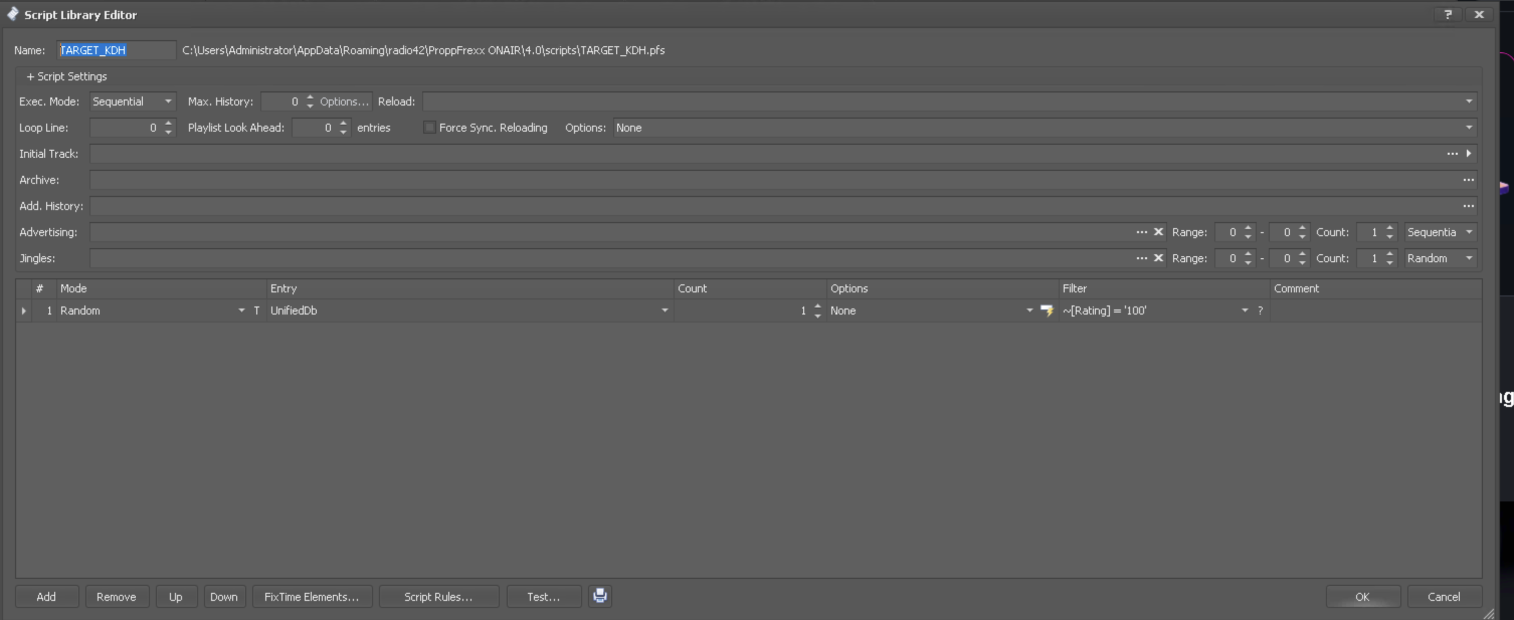

I am tinkering around scripting. I have created these "target" scripts that just have 1 entry, based on the filter I've provided as such.

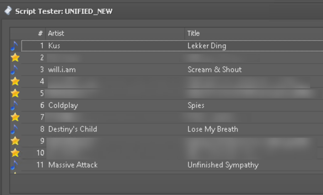

When I test the script, I see that sometimes double jingles are being put in the script. What could be the cause of this?
Here's the debug log from the script in the screenshot;

I've redacted some jingle names for privacy concerns.
The Executed scripts do not have any "jingles" present in them. It's just a script with 1 line, set to random with some filter.

Post by Thijmen »
And that's totally fine. However, there are two jingles between tracks, while these jingles dont come from the actual scripts that are being referenced. Am I running into a bug or misunderstanding how the jingles work?
Expectation: at most 1 jingle between tracks
Current behavior: two jingles between tracks

Post by Thijmen »
The scripts I execute do not have any jingles. For example, this is how one looks:
