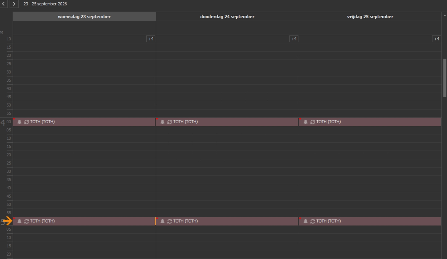

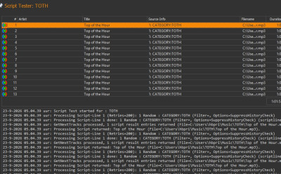

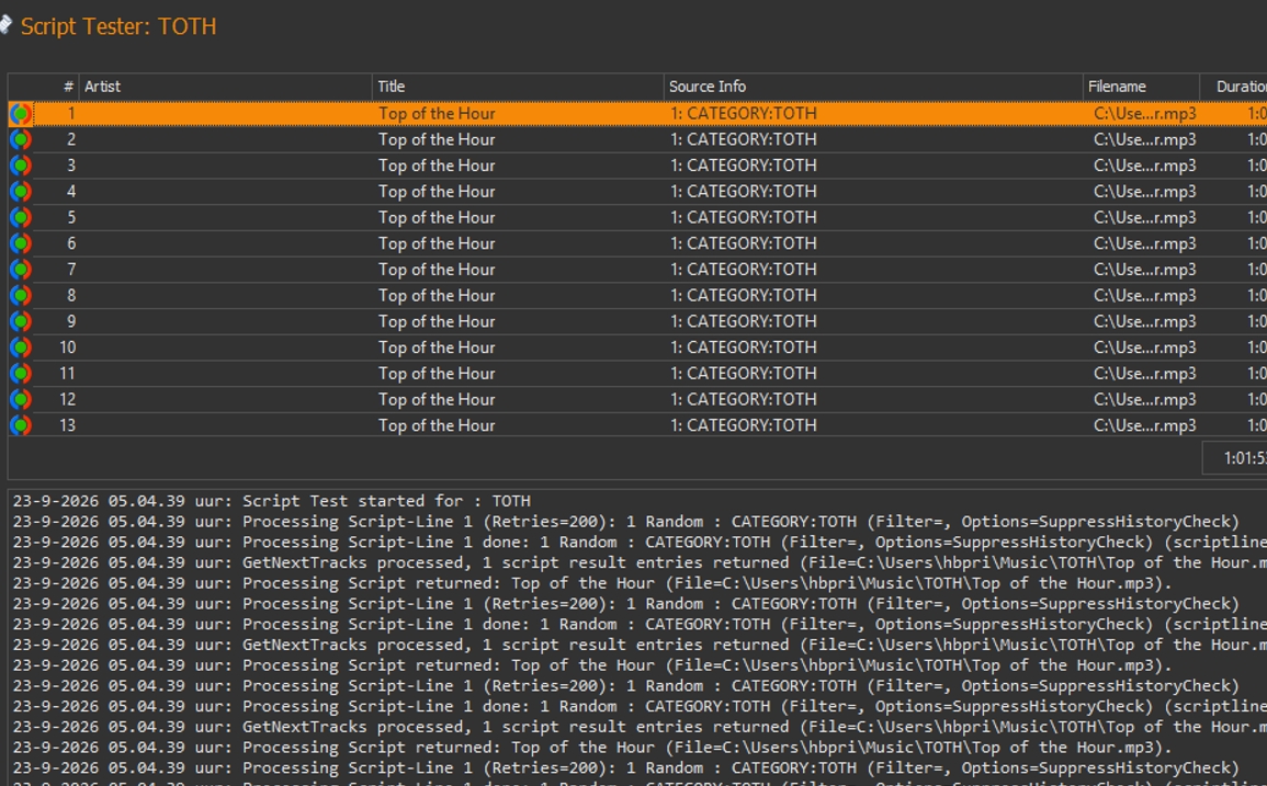

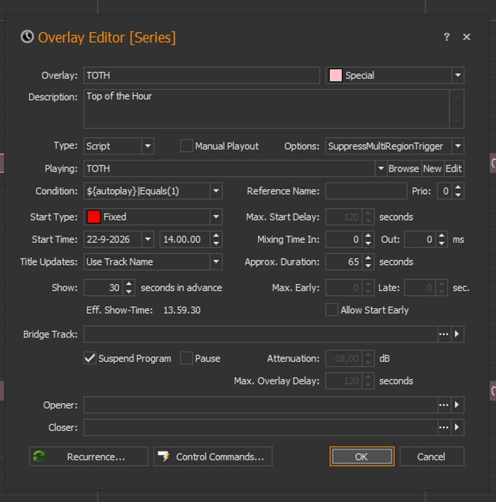

The TOTH must play every hour , set the correct settings but the TOTH wil not play. See attachments. Tested the script, no errors.

Can you may be first explain how you defined the TOTH song?
Is it via an Overlay? Did you use ‚As Playlist Insert‘ or do you play it via the Overlay? Or is it a fixed or soft start?
Have you looked in the Overlay Scheduler log?

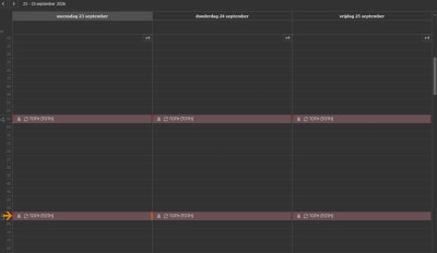

I did it this way

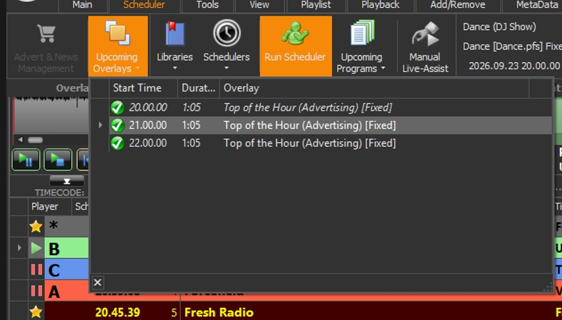

And is the Scheduler Log showing and entries? See the Tios ribbon tab, Show Logs…

Re: TOTH not playing

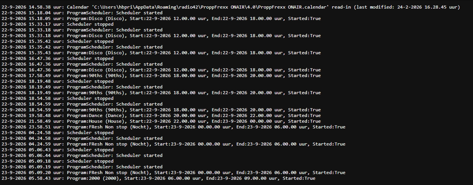

This one?
Almost.
That is the Program Scheduler log.
I need the log for the Overlay Scheduler.

it's the professional version. and i'm running the scheduler. Normaly you will see a popup screen when the TOTH is starting.. is also not showing
That sounds like the overlay player is not starting. But then a log entry would even be written in the overlay log, which is puzzling why this is not the case.
Can you temp. enable the ‚Debug Logging‘ may be that reveals an issue. You need to send me the Debug….log file.
