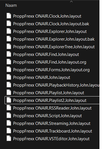

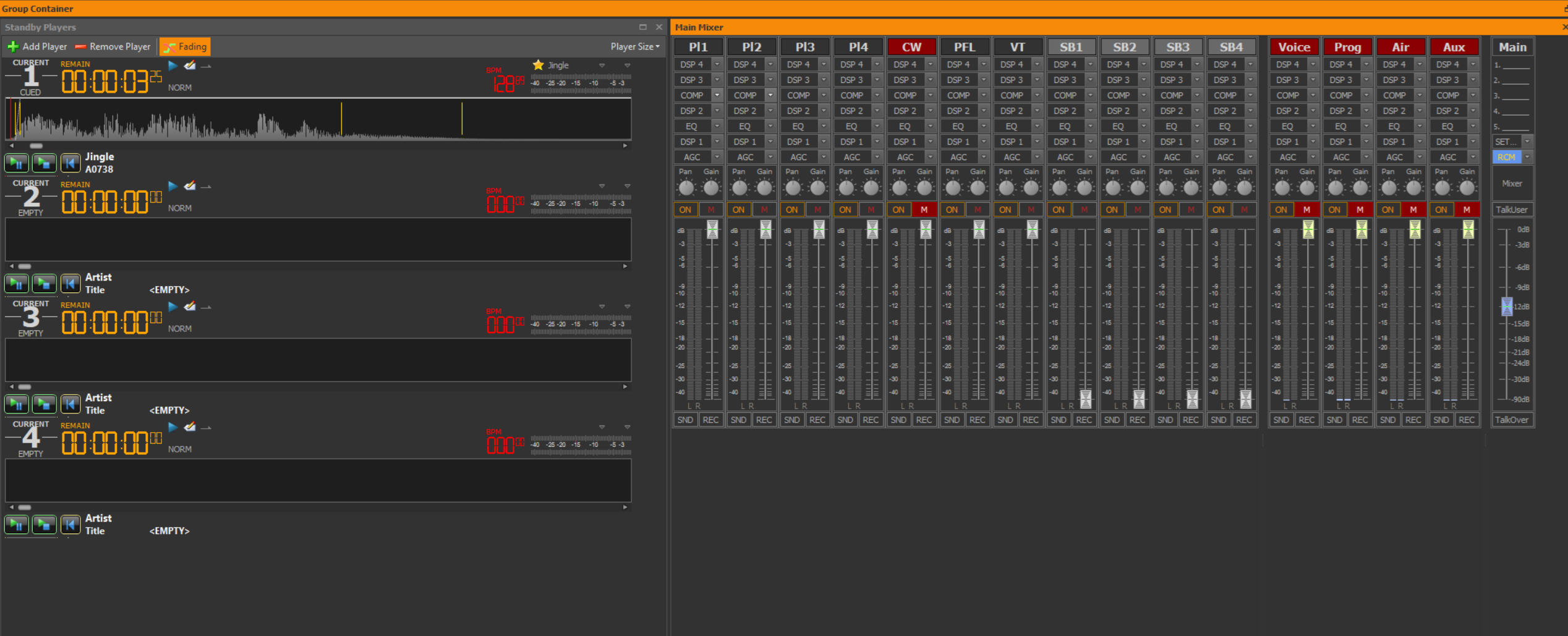

Here is what I did. I deleted all the layout files for the user.
I then created a Group Container on the second monitor and added the Standby Players and the Mixer to it.
After that, ProppFrexx no longer closes when I try to exit the application. Nothing happens.
If I remove either the Standby Players or the Mixer from the Group Container, everything works as expected and ProppFrexx closes normally.

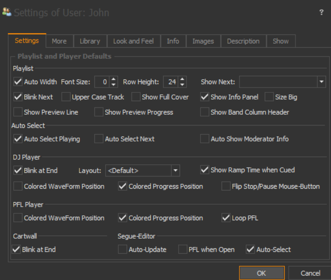

John2103
Posts: 49
Joined: 11 Nov 2019 16:32
Re: ProppFrexx Won’t Close When Using a Group Container on a Second Monitor
Post by John2103 »

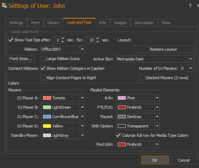

These are the user rights and settings.

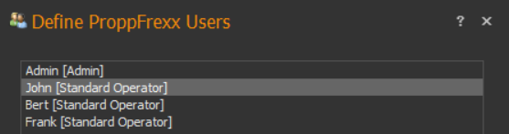

John2103
Posts: 49
Post by John2103 »
I did another test. I created a new user (John2) and assigned the same permissions (Standard Operator). ProppFrexx still refuses to close when I place the Standby Players and the Mixer inside a Group Container on the second screen, even with this new user.

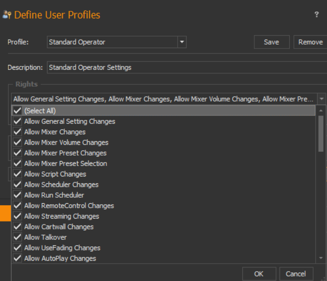

I mean the rights (not the user settings) of the „Standard Operator“.
I haven’t tested the UAC case yet, will do later…

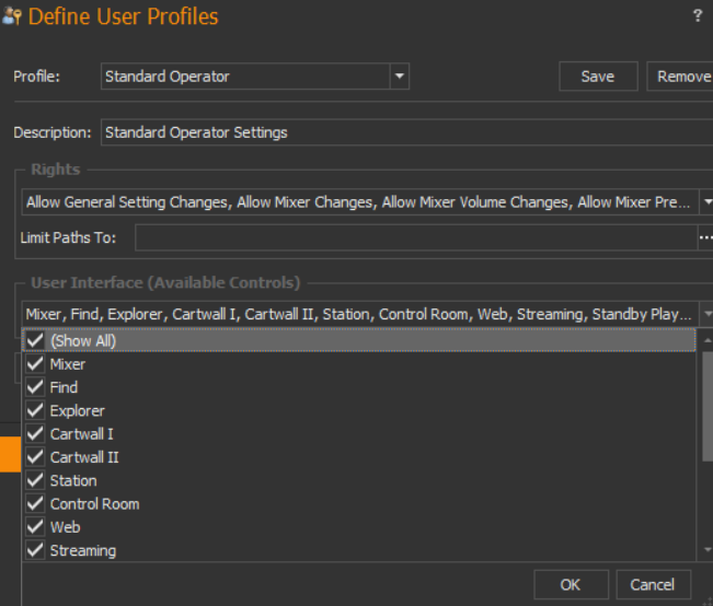

John2103
Posts: 49
Post by John2103 »
See screenshots below. I also tested with an admin account. Same results.
