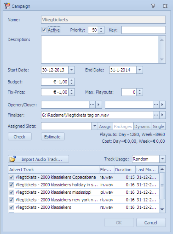

Thanks for your reply. However, if I look at my sequence, it looks like this :
- Slot-Openener
- Campaign1 ('Kruidvat') - Track
- Slot-Separator
- Campaign2 ('Vliegtickets') - Track
- Campaign2 ('Vliegtickets') - Finalizer
- Slot-Closer
When looking at your definition of the full sequence of and advert slot you would expect it to be
- Slot-Openener
- Campaign1 ('Vliegtickets') - Track
- Slot-Separator
- Campaign2 ('Kruidvat') - Track
- Campaign1 ('Vliegtickets') - Finalizer
- Slot-Closer
That way the finalizer is separated from the actual campaign track.
I didn't include an Slot-FinalizerSeperator, you're right about that. But that shouldn't have af anything to do with the order, I guess ?
Kind regards,
André

The full sequence of an advert slot is like this:
- Slot-Opener
- Campain1-Opener
- Campain1-Track1
- Campain1-Track2
- Campain1-Closer
- Slot-Separator
- Campain2-Opener
- Campain2-Track1
- Campain2-Closer
- Slot-Separator
- CampainN-Closer
- Slot-FinalizerSeparator
- Campain1-Finalizer
- Campain2-Finalizer
- CampainN-Finalizer
- Slot-Closer
Your above sequence looks like this:
- Slot-Openener
- Campaign1-Track
- Slot-Separator
- Campaign2-Track
- Slot-Closer
This seems to be absolutely in line with the original definition.
Note, that when no Campaign-Opener/Closer/Separator tracks are defined, they are of course not used.
But you have defined a Campaign-Finalizer track - as such it is played at the end of the sequence right before the Slot-Closer!
So I am not sure what is wrong with your sequence?
Posts: 9232
Re: Campaign tag on bug
Where have you defined, that 'Vliegtickets' is Campaign1 and that 'Kruidvat' should be Campaign2 ?!
If both campaigns do have the same 'Priority' it is random at which order they are played!
There is no internal rule existing within PF saying, that a campaign having a finalizer track should be played first!
The 'Priority' property value actually defines the order in which campaigns might be used.
