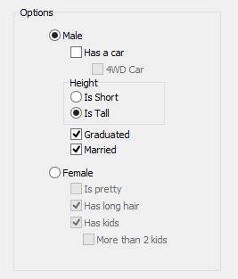

Bernd I think that settings should have the attached image's look.
That way no one will confuse.
Because having settings with so many checkboxes, a conflict might occur if both of some checkboxes are checked.
Options Example.jpg (12.31 KiB) Viewed 7839 times
It's just an example wrote in a few minutes. ;)
