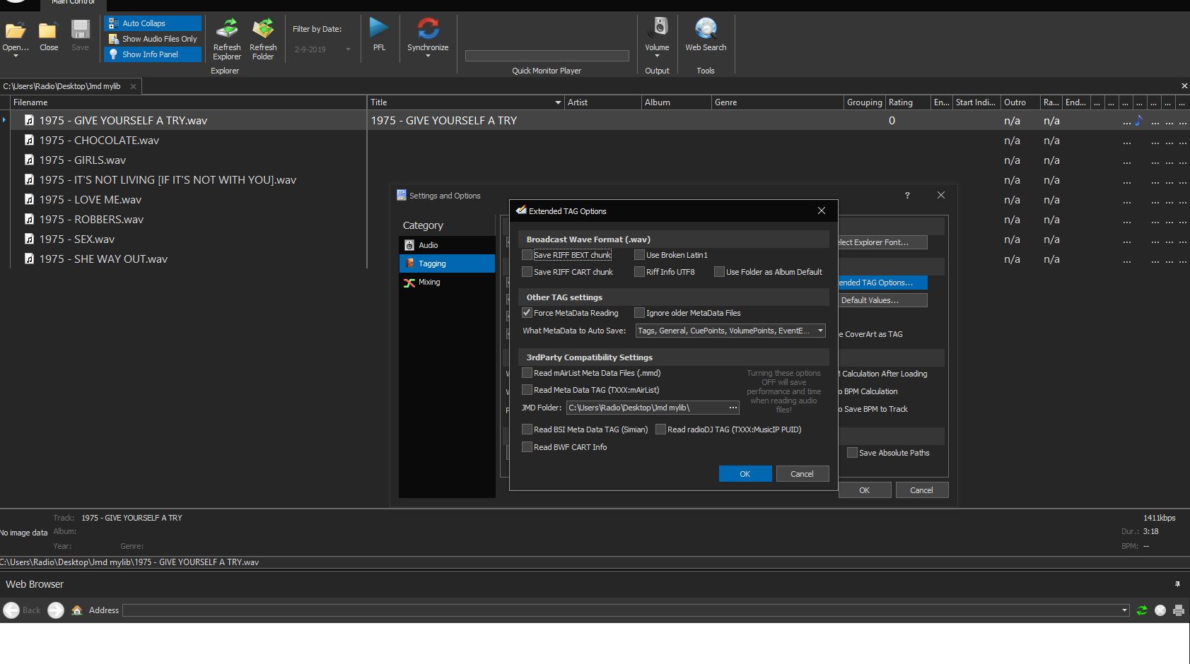

No no no
Sorry
I don't use mmd (it was only a test)
Facts:
- I have Wav files completely empty (No RIFF content or whatever)
- I have JMD files for these wave files
Here are 3 test wav incl JMD https://fromsmash.com/Jmd-files (to big for this forum upload)
JMD gives no result. Maybe my config isn't wright or a bug or....
Config see attachement
Facts:
