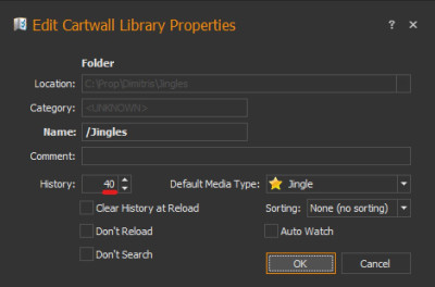

To prevent this, you could set the script-line option ForceLibraryHistoryCheck and then set a library history, if eg. 40 - which will ensure, that no duplicate track for the last 40 selections will be picked.

Just to be clear, when you say 'library history', you are reffering to the (song)history option that is avalaible in the (cartwall) library settings of each library?
Posts: 9139
Re: Last played in 'hours'
Exactly, you define it here...
