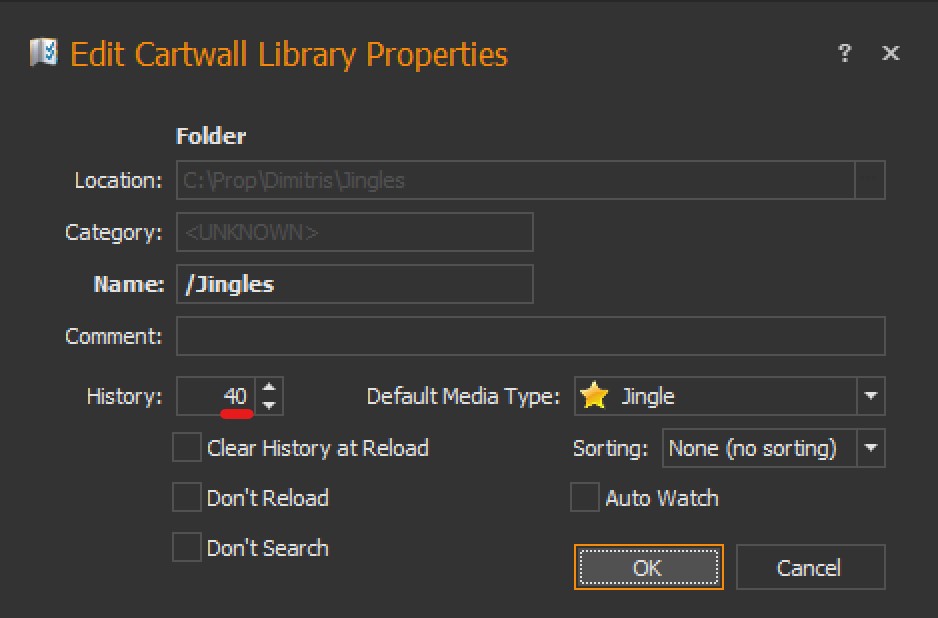

I assume, you are using the ‚cartwall‘ script-line mode and the default script-line options dientest mode, which is SuppressHistoryCheck and SuppressAddHistory?!
As the mode ‚cartwall‘ only uses the Random mode out of a cartwall library, you are right, that in that case repeats could happen.
To prevent this, you could set the script-line option ForceLibraryHistoryCheck and then set a library history, if eg. 40 - which will ensure, that no duplicate track for the last 40 selections will be picked.

Hi Bernt, thanks for the (lightning spseed) quick answer.
Just to be clear, when you say 'library history', you are reffering to the (song)history option that is avalaible in the (cartwall) library settings of each library?
Re: Last played in 'hours'
Exactly, you define it here...
