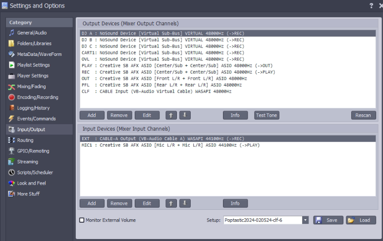

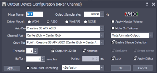

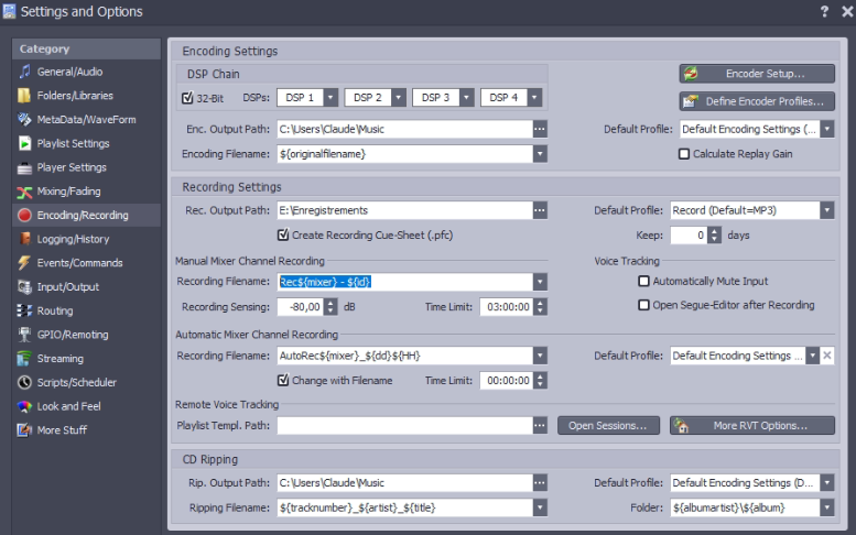

About my recording issue on the REC channel and on my PFL issue on the EXT channel (DJ remote via Cleanfeed):
Here are the screenshots of:
REC channel mixer (identical (except for copy to, of course) to the PLAY channel which works perfectly for recording)
Recording configuration
and Input/Output configuration
I hope this will help with understanding these two issues.
Thank you for your help.
