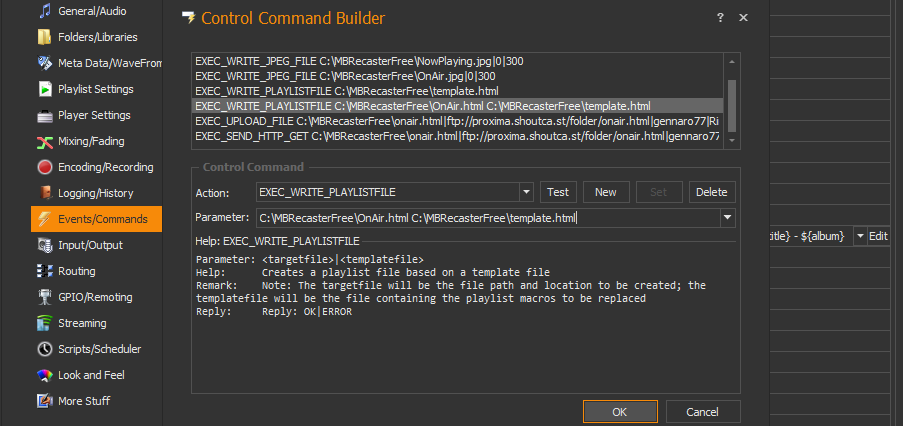

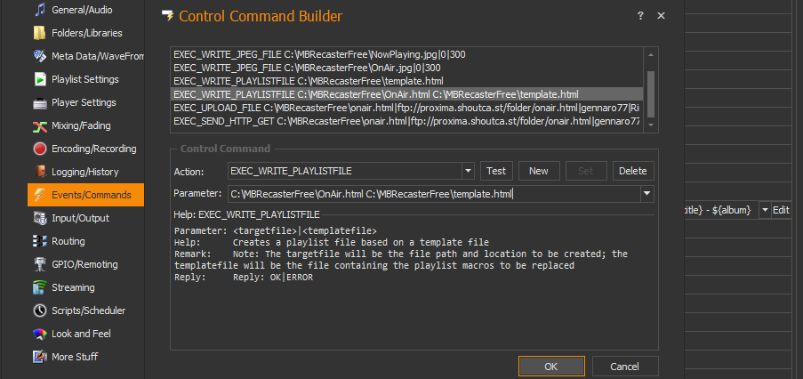

the command used is the following but I can't make it work and then I don't see it on my site when I go to load it thanks if you help us with some screenshots

Seems you are missing the PIPE symbol (|) between the target and template file. You have used a space instead of the pipe.
You have (in your previous command) also only used one parameter in the EXEC_WRITE_PLAYLISTFILE command?!
This command seems to appear twice.
E.g. it should be:
EXEC_WRITE_PLAYLISTFILE C:\MBRecaster\onair.html|C:\MBRecaster\template.html
