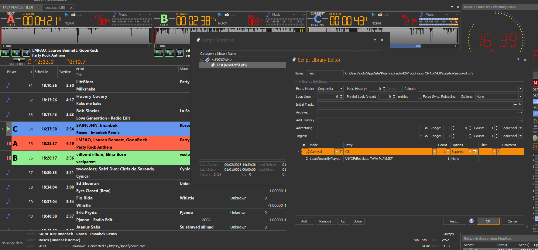

Yes, this is not a program where I want to use scripts. I have an existing playlist that is currently playing, and I want a station jingle to play after each song. I want to apply this to the active playlist. Would you be willing to set this up for me via TeamViewer? I’m willing to pay for your time. :)

When you have an existing playlist you need to insert those jingles manually into that playlist - you can only automate things via a script, but not to a already created playlist by just playing that playlist and do things on top... that is not how ProppFrexx works.

I can't. I have a list with several thousand songs. But using the 'add track' option, I can only add either 12 hours or 99 songs.
That's beside the point. I set it up like this for now (see the picture). For some reason, in the test, it only adds the jingle taken from the cartwall at the end of the list, not between each song. Why?

The 'LoadPlaylist' script-line mode loads the entire playlist (in that single script-line). And after the next script-line is executed... so what you experience is exactly what you define and who this scrip-line mode works.
So use the LeastRecentlyPlayed mode as explained above.
In this case (I assume what you try to do) please do the following:
  • create a playlist based media library, using the pls file you just specified above
  • now create a new script and define again two script-lines (as initially explained)
    1. using the media lib you just defined
    2. using a jingle cartwall
  • now try again and 'Add Tracks from...' using that script
  • and yes, this function has a limit of max 23h:59m:59s, but why would you pre-create an even bigger playlist than a complete day
  • ProppFrexx can schedule and run recurring script-programs for each hour or day - so there is no need to pre-create such huge playlist
