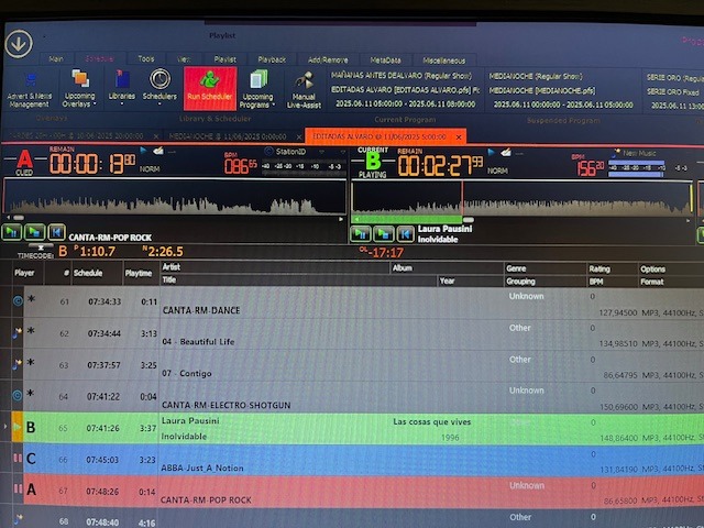

I'm sharing the settings I programmed in "FIXED" and the screen where the playlists accumulated when programming in this mode.
The settings are the default ones, they have not been changed.
Re: Program Scheduler crash Propprexx in the 12th instance
No, not really - FIXED also works fine.
But your issue is, that you defined the program entries as "Overlay: Overlay End Time Fixed" -
so please define all your regular program entries as "Overlay: No Overlay"!
You only get these overlay types proposed, if your program entries timely overlap with each other and are not starting and ending consecutive (i.e. the previous ends at e.g. 18:00 and the next starts at 18:00).
(else the programs are not started as regular programs, but as overlays over the underlying root program; and an overlay only gets closed when this root is closed - which didn't happen in your case)
