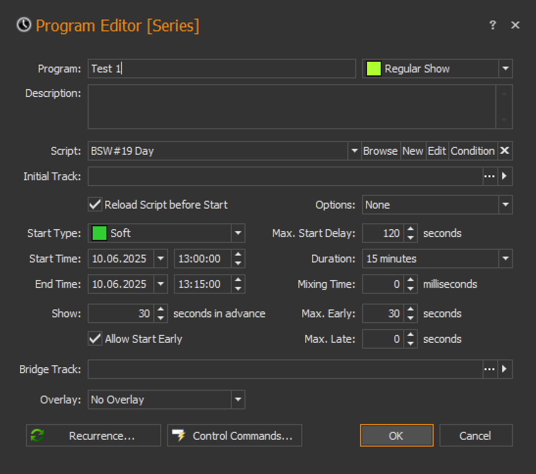

1) The Program Scheduler Entry as an example: I ran four hourly recurring program every 15 Minutes (for testing) in Soft mode - it runs a sample script which looks like this:

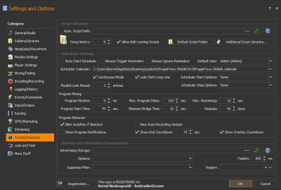

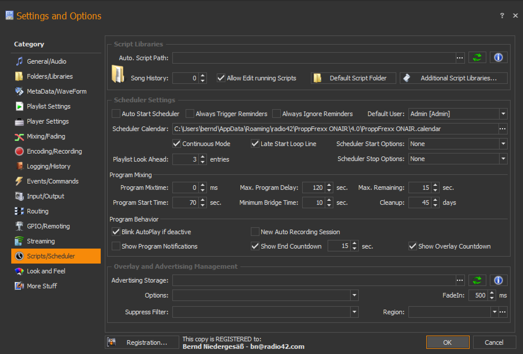

2) I left the general settings all as default:

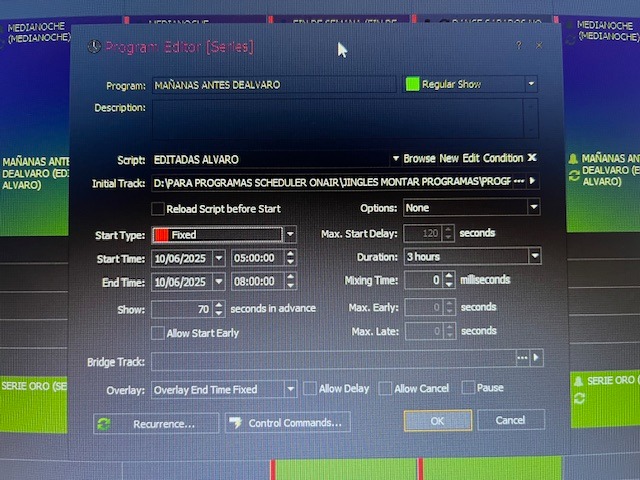

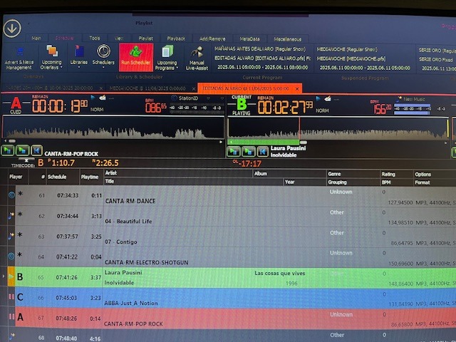

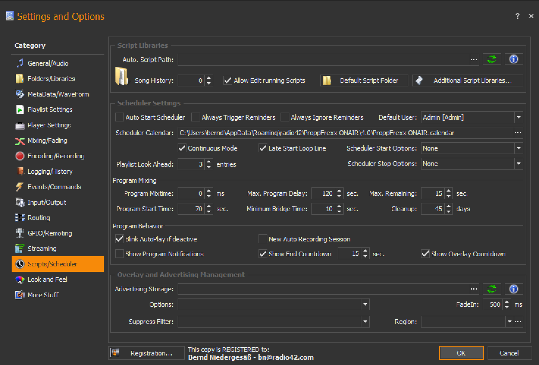

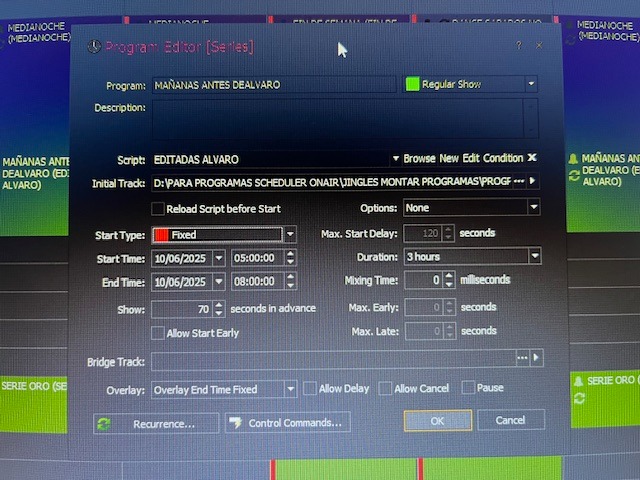

I'm sharing the settings I programmed in "FIXED" and the screen where the playlists accumulated when programming in this mode.
The settings are the default ones, they have not been changed.
Posts: 9160
Re: Program Scheduler crash Propprexx in the 12th instance
No, not really - FIXED also works fine.
But your issue is, that you defined the program entries as "Overlay: Overlay End Time Fixed" -
so please define all your regular program entries as "Overlay: No Overlay"!
You only get these overlay types proposed, if your program entries timely overlap with each other and are not starting and ending consecutive (i.e. the previous ends at e.g. 18:00 and the next starts at 18:00).
(else the programs are not started as regular programs, but as overlays over the underlying root program; and an overlay only gets closed when this root is closed - which didn't happen in your case)

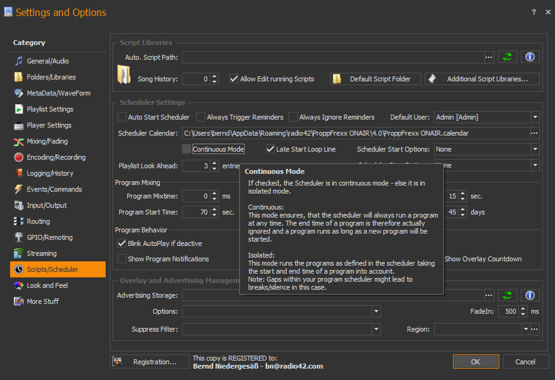

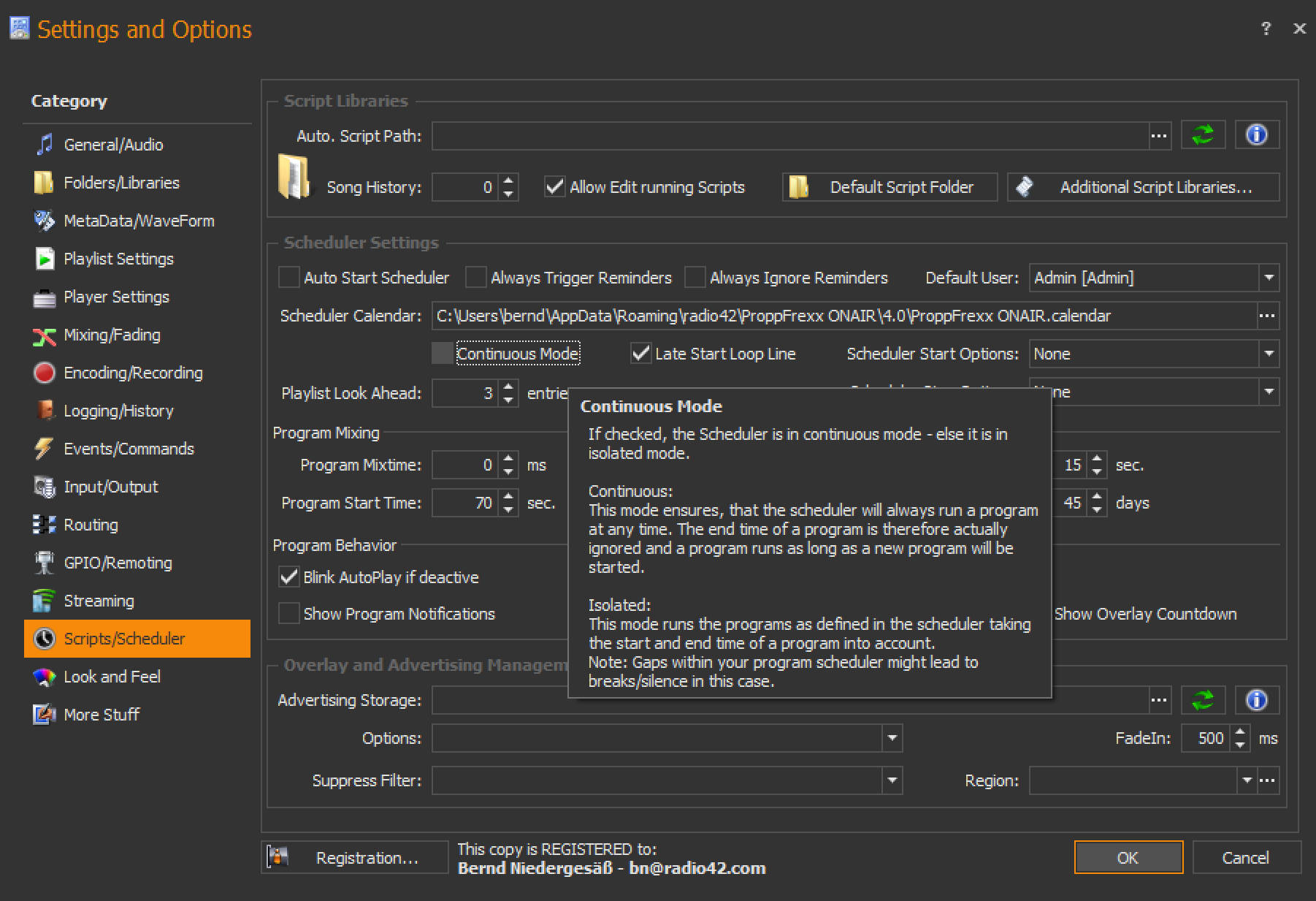

Hello, and sorry for not answering sooner. We're trying out several ways to do the program, but we haven't found a way to do anything specific. That would be to completely stop the program at a specific time. For example, we're scheduling a show from 12:00 AM to 5:00 AM, followed by another from 5:00 AM to 8:00 AM. At 8:00 AM, we'd like to stop everything so we can do a live show. But we can't get it to stop at 8:00 AM. Does the program continue or does it stop and resume the previous show from 12:00 AM to 5:00 AM. How could we make it stop at a specific time and not play anything else? Thank you.
Posts: 9160
This is because by default the scheduler is set in Continuous Mode. In continuous mode a program runs until a next program starts (where effectively the end time of a program is ignored).
You need to disable this mode (aka Isolated Mode), so that a program only runs from its defined start til the end time.
Hoover of the checkbox to see its tooltip - or click on the ? icon at the very top right of each dialog to get help about each options...
