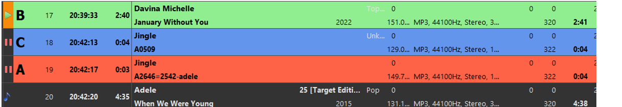

There are no rules or restrictions defined. As you can see in the screenshots below, the situations are similar.
In this example, the playlist is correct.
In this example, the song by Kelly Clarkson is missing.
