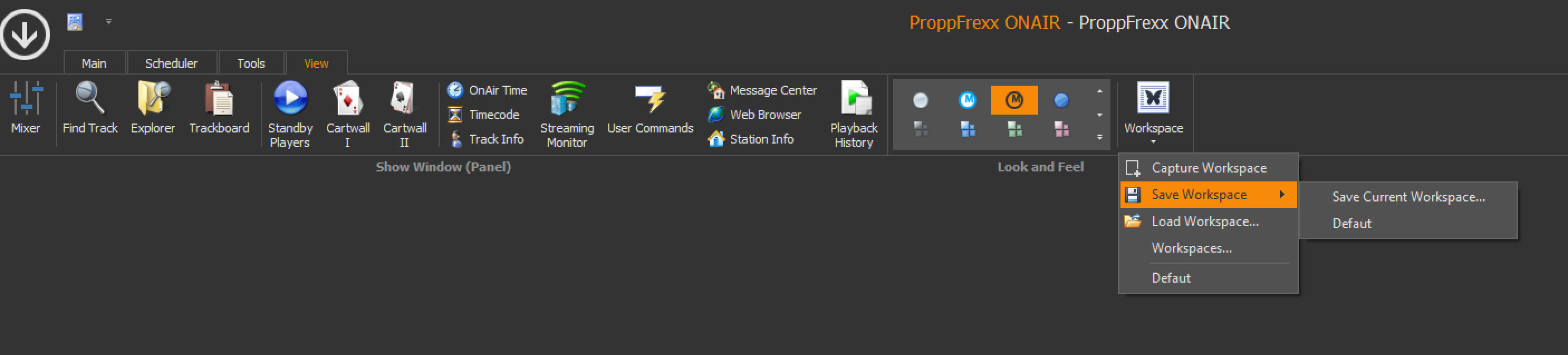

But I implemented a feature already some years ago, so that you can always restore your layout.
See the 'Workspace' menu in the 'View' ribbon tab. Here you can save and restore or manage any number of saved layouts (so called workspaces).

As I can not reproduce it. It might only happen, if your config files can not be saved resp. gets corrupted! Ie. You should check your harddisk?
Plus I intentionally added the workspace menu, with which you can always restore your last layout WITHOUT deleting any layout files.
There must be 2 entries in the Workspace ribbon menu: Default and Last Used Workspace.
Are these entries also not working resp. existing?
