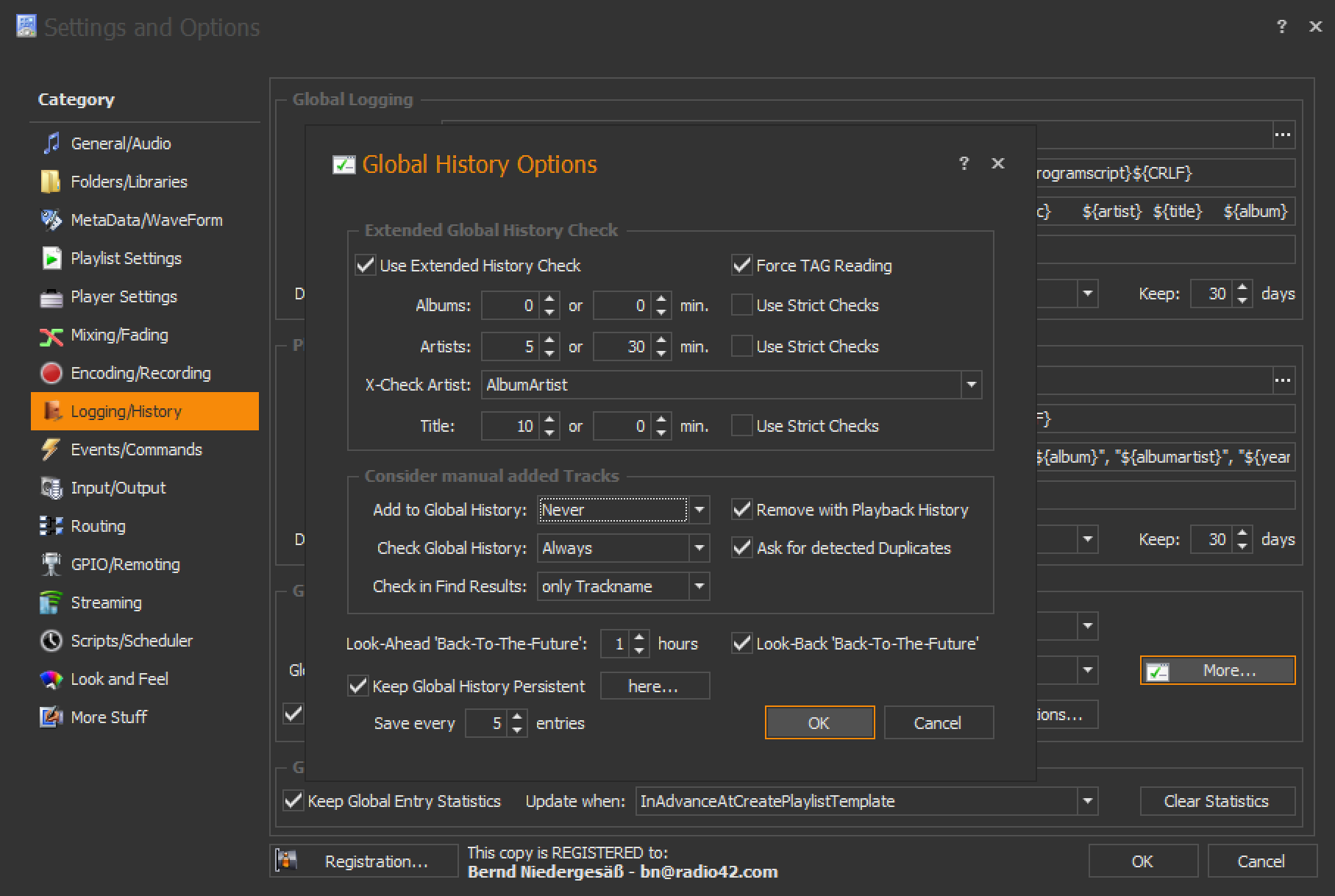

Note, that in each script-line you have a separate option to check and/or add tracks to the history - see the script-line Options:
- SuppressHistoryCheck
- SuppressAddHistory
So for all irrelevant script-lines you might set the later option.
However, this of course doesn't apply for VoiceTracking, where tracks are added manually, you might set the option to 'Never' add them to the global history - see the "More..." options.
However, I might also add a new option to the next version to always force to apply the 'Exclude' filter also for adding tracks to the global history.
