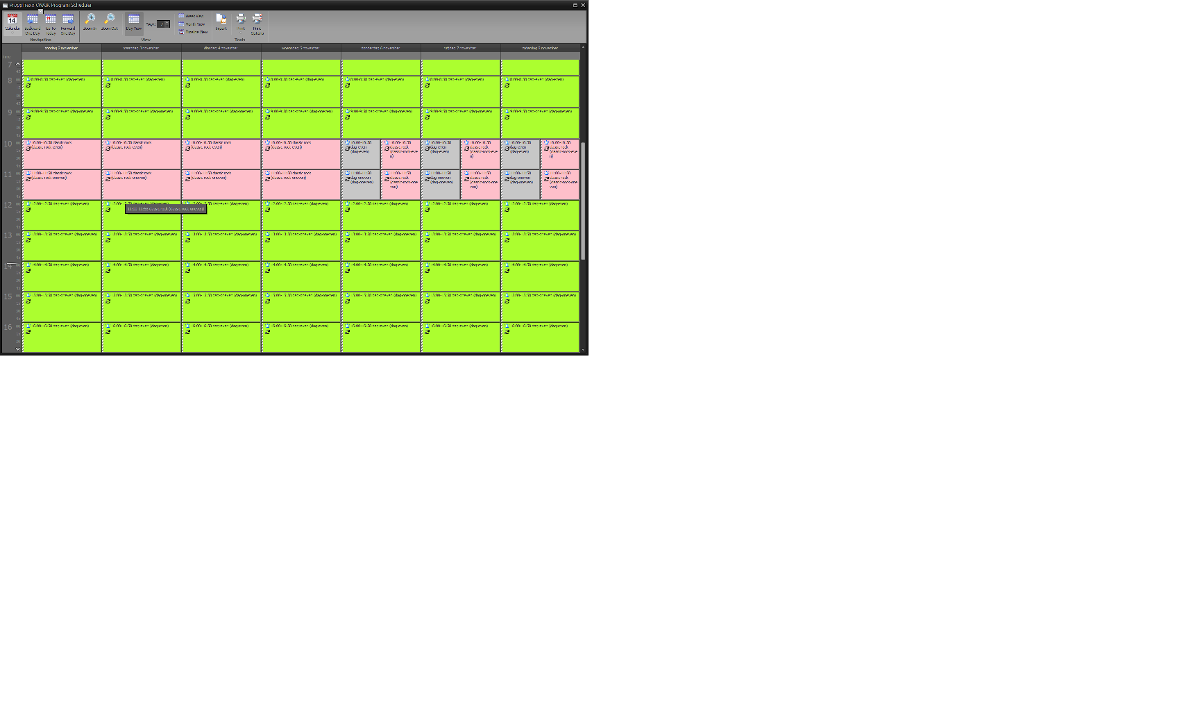

For a few weeks I've been having problems with my program scheduler. Every day from 10:00 -12:00 there is a program (Classic Rock) That should repeat itself every day. But every time my normal daily program is also scheduled at the same time..So there are 2 programs listed at the same time. Could you tell me what is wrong with it? (see added file)
- program scheduler.png (44.19 KiB) Viewed 11652 times

Ok, when you take a look at the attached file in my first post, you will see my program scheduler. The programs with the "green" colors are my regular daily programs. The "colored" programs are only listed every day from 10-12 hr. When you take a good luck at the "pink colored" programs you can see that it's been "overruled" by a "grey" colored program. And that program is my regular daily program. That should not happen.

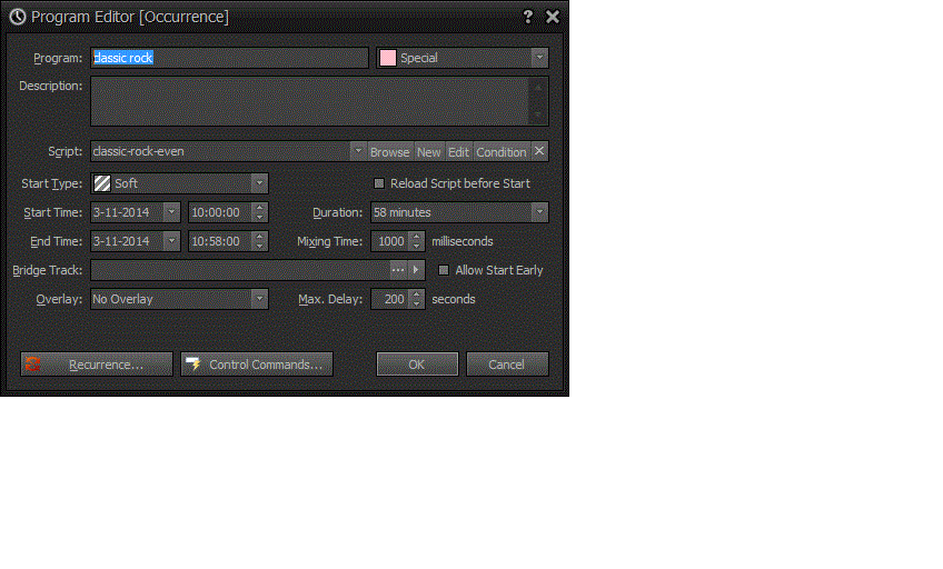

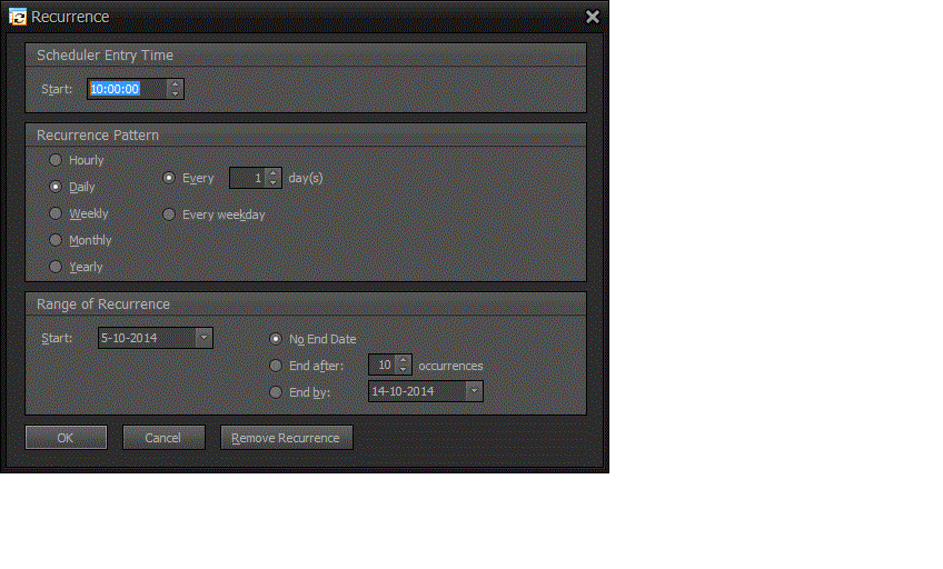

To make it hopefully clear for you, I've attached my program scheduler entries for the "pink" colored program.
- program editor2.gif (66.99 KiB) Viewed 11641 times
- program editor1.gif (57.25 KiB) Viewed 11641 times

In your scheduler image you posted initially I do see 2 parallel entries between 10-12h.
The pink and the gray one.
If you only want one program, why don't you delete the 2nd one?
