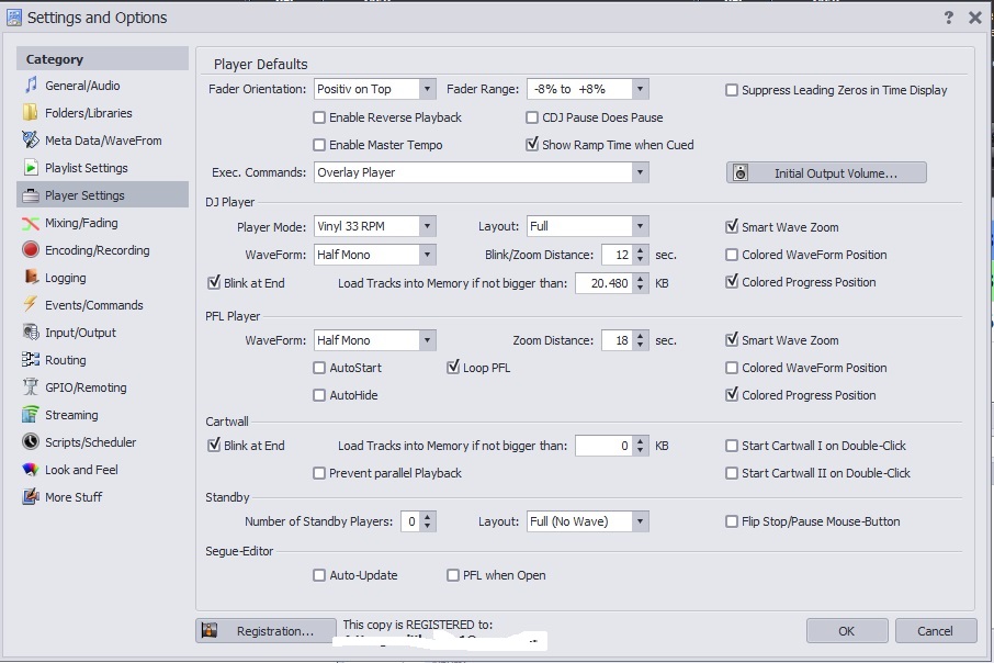

- player settings-.jpg (139.74 KiB) Viewed 6553 times

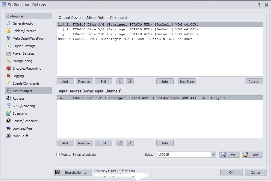

- in-out settings-.jpg (116.59 KiB) Viewed 6553 times

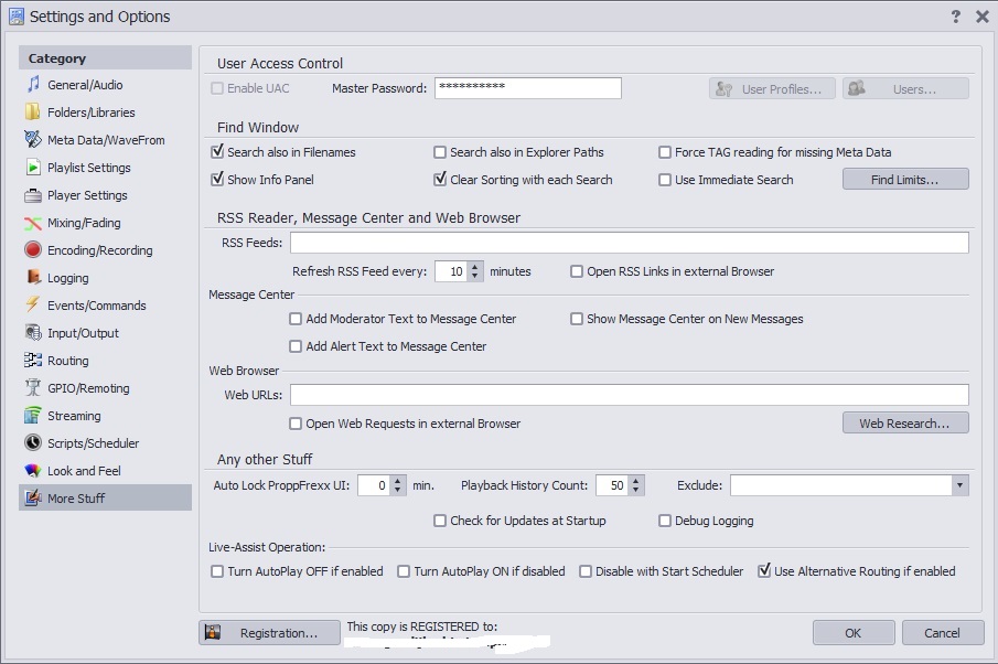

some more pics:
attachment=1]more stuff settings-.jpg[/attachment]
- player settings-.jpg (139.74 KiB) Viewed 6552 times
- more stuff settings-.jpg (136.2 KiB) Viewed 6552 times

So you have defined 4 mixer output channels (lijn1, lijn2, lijn3 and xxxx).
What are the settings per mixer channel? (double-click on each mixer channel name to open the related config dialog)!
E.g. when something plays on 2 outputs, make sure, that you haven't activated either the SND function NOR the 'Copy To' option in the configuration.
E.g. when something doesn't play at all, make sure you really selected the correct soundcard device/channel combo AND you did not accidentally MUTE the channel.
