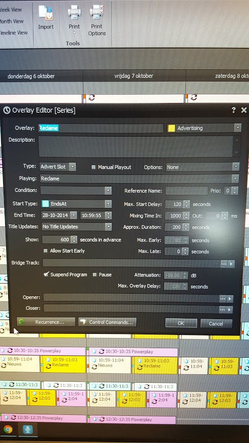

Settings overlay:

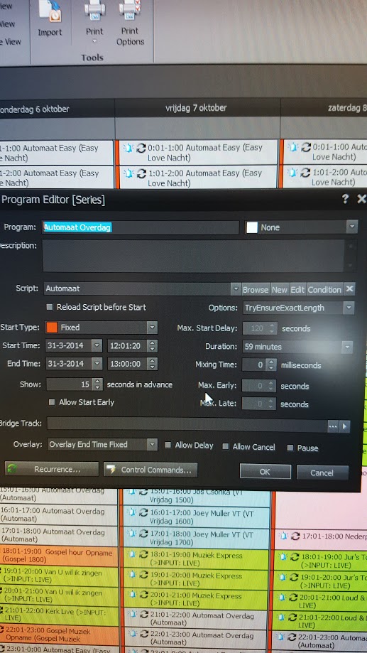

And after the overlay is done, this program is started:
What is going wrong because in PF3 it is working perfectly.

You say: the overlay is not started ... and after the overlay is done, this program is started.
So it is not really clear to me what exactly is happening resp. not happening.
However, no, the EndsAt option is not disabled in v4.
To see what exactly is happening, please enable the 'Debug Logging' option in the general settings, section 'More Stuff' and then please re-try. Once you are done and have 'reproduced' the behavior, please send me the created Debug_ .log file with the approximate time when something should have been happened. The Debug_ .log file can be found in the log sub-folder of the ProppFrexx AppUserData folder.

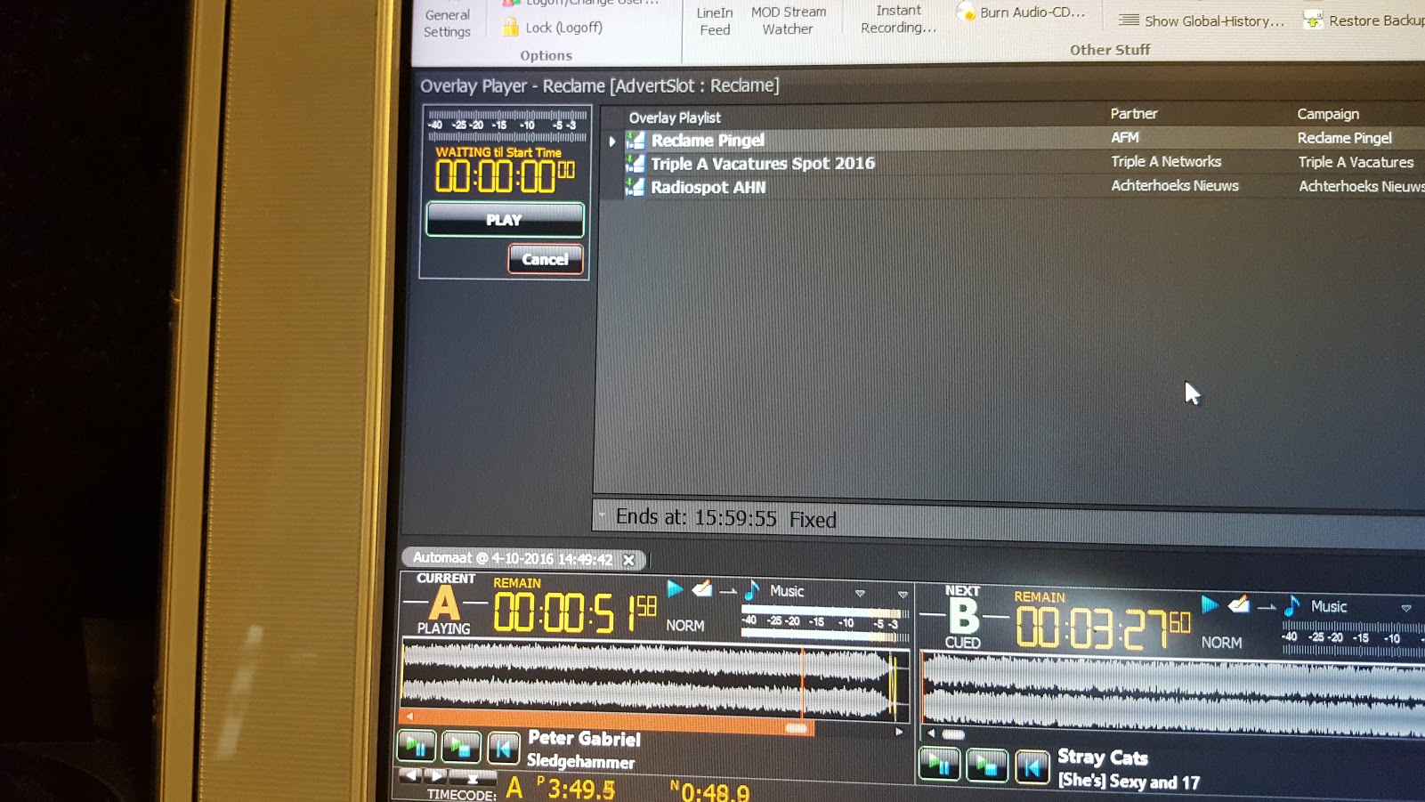

Sorry for being not clear. I mean the overlay is loading and I can start it manually but it's not started automatic like a EndsAt should.
When the timer of the overlay reaches 0 it does nothing and keeps playing the playlist unless I press play. (see screenshot)
Manually playout or manual live assist are disabled.
